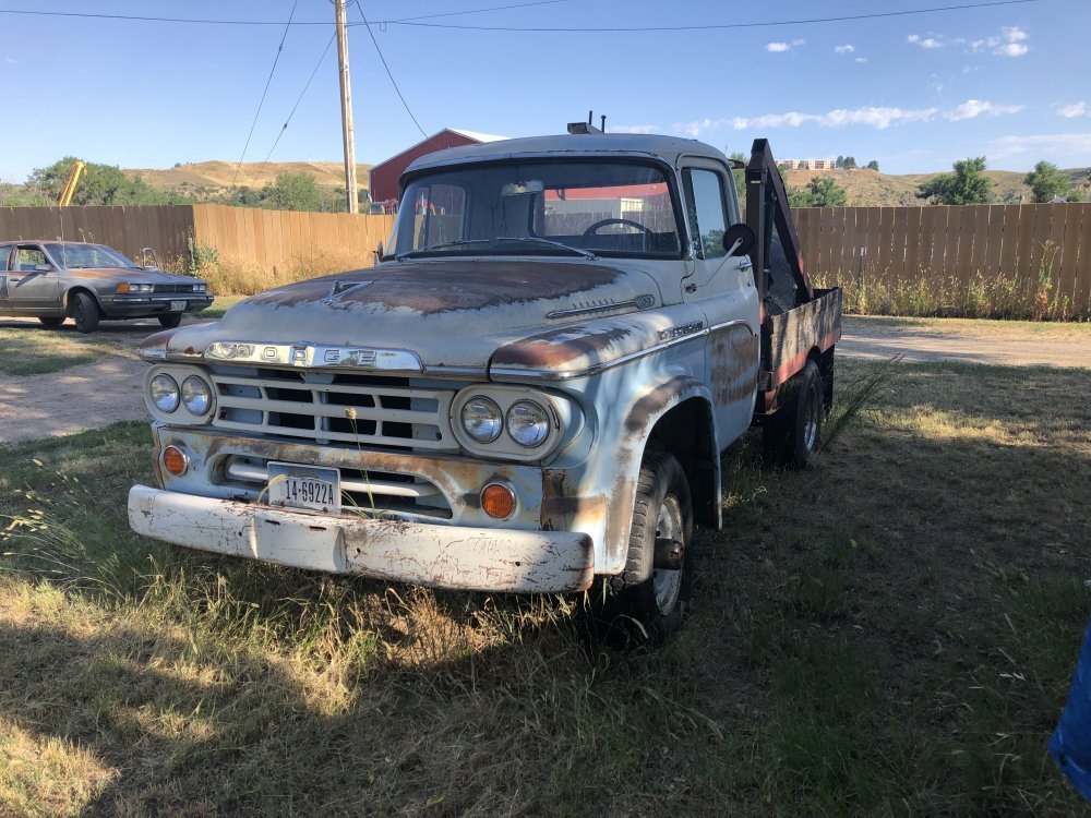

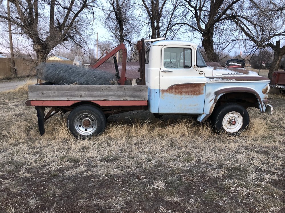

When clutch masters rebuilt the clutch for My 1959 Dodge W100, one question he asked is, are You ever in situations where You have a need to ride the clutch ?
Yes, the 59 is used in situations such as that. There is a 6,000 pound winch mounted to the front of the bed, that winch is used to power a set of gin poles for lifting and gently placing items, engines and such, and thats when the clutch pedal is feathered to jokey the truck into such positions.

Full mechanical restoration.
Maybe, someday, it might get a paint job.
I’m not a huge fan of rusty patina.
