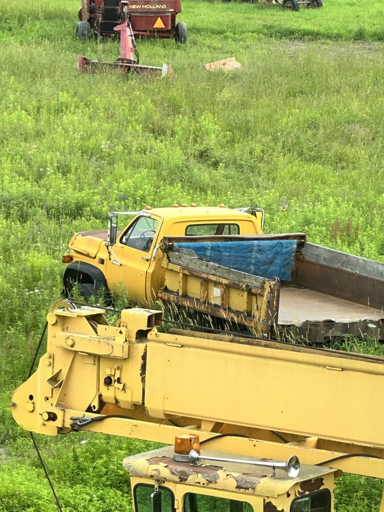

Damn! Sorry I couldn’t respond sooner. I really wasn’t expecting a detailed response like that!
I hate anything electronic and almost everything I own is mechanically injected. In the past 10 years I have put 10 miles on the truck. I just use it for farm work and the occasional trip to the Neighbors. My last experience with the 6.5. Was negative as the photo eye that took the timing off the crack was not functioning correctly as I had fuel with algae in it on a trip to North Carolina
My goal is to simply have a bit of fun and kinda restore the truck. It has a 4 speed manual in her that I kind of enjoy as it reminds me of my 77 gm 1 ton.
As for your mandatory question…. I would say 5k for the engine and another 10 to get her road worthy. It was a plow truck and I want to use those hydraulics to put a cattle derailleur up front for fun etc.
With that budget keeping in mind I am going to do everything myself. What are your thoughts?
