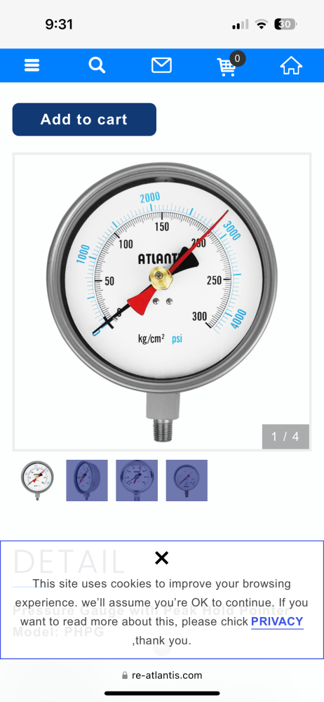

the gauge that comes with the low cost testers almost always suck.
You can replace the gauge with better ones- and if you want get ones that have two needles - one shows live and the other gets pushed to peak and stays there- see pic. Note I am not saying use this brand gauge- just a random example found online quickly.
You can also get a pressure retention valve like a compression tester uses that holds peak until you release it.
You can also get digital gauges that record peak.
Doing it on the cheap- put your phone video recording on slow motion record and test it. Then play back. But realize you need a few cycles and have to learn to pump the handle properly. Like learning to use a feeler gauge- it is not hard but takes a little goofing with it is get the feel.

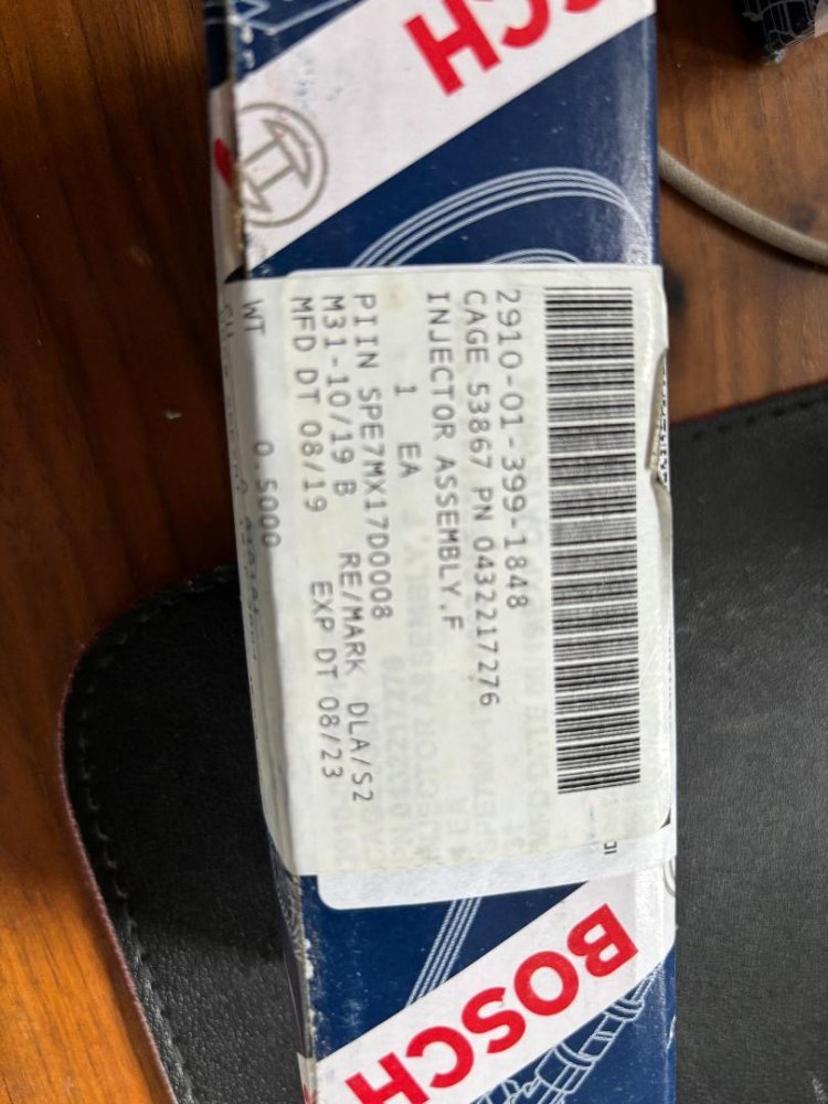

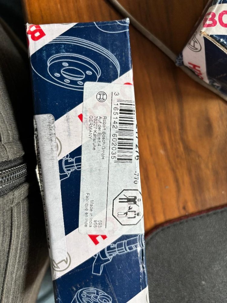

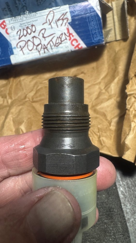

OK, I got my sets of these injectors and I have an idea of what’s going on. Barcode stickers clearly show Bosch Made in India. They also show a manufacture date of 08/19 and an expiration date of 08/23. I wondering if these were from the production years in which they had quality problems which led to failures?
I put a set from Leroy in my ‘99 about 3 years ago, but did not note the date of manufacture. I ran them about 12K miles until my engine failed due to a worn oil coolant line causing loss of oil pressure. Paveltolz had Bill Heath test those injectors and at least 2 had problematic streams of fuel upon pop testing. The rest were passable. I still put new injectors from Quadstar into the new engine.
Would be interesting to hear what were the problematic years of production and the specific parts that were the problem.
View attachment 92588View attachment 92589
I wouldn't trust any of them. Test and balance them all.
