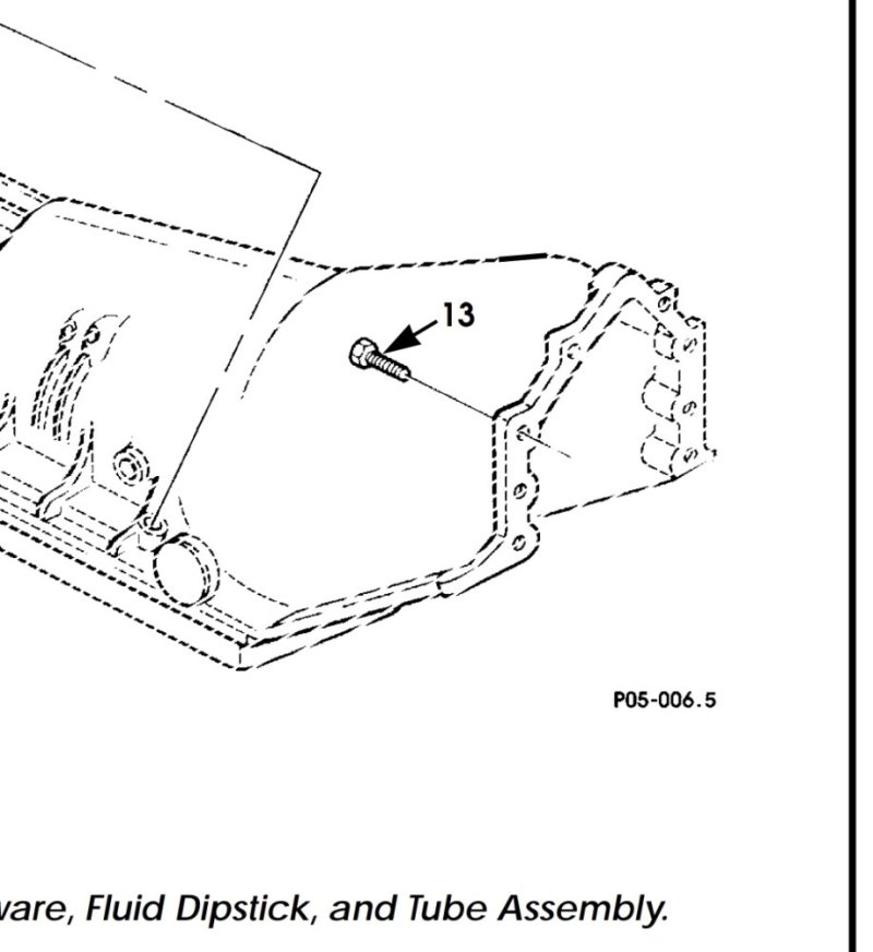

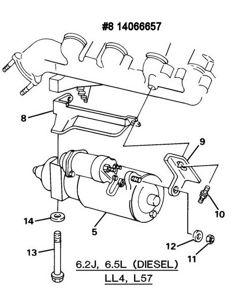

I'm confused. #10 looks like a stud. And is shown going to the exhaust manifold.
Is that just a stud or stud and nut?
That doesn't seem right at all.
I know I have some M8 x1.25 studs here. I'm wishing I had and Allen screw to use for a stud into the block for the starter brace.
I have a heck of a time touching that bolt much less doing anything with it.
From our 1996 factory service manuals.
Starter bolt torque specs
Starter through bolts M10x1.5 35' lbs
Starter brace bolt M8x1.25 24' lbs
Starter brace nut 1/4"-20 tpi, 75" lbs or 6.25' lbs

That is just a bad drawing, the shield bolts to the starter brace bolt or stud on the block.

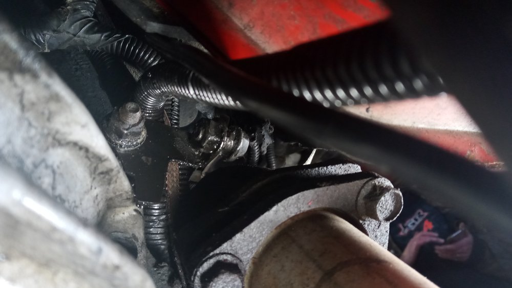

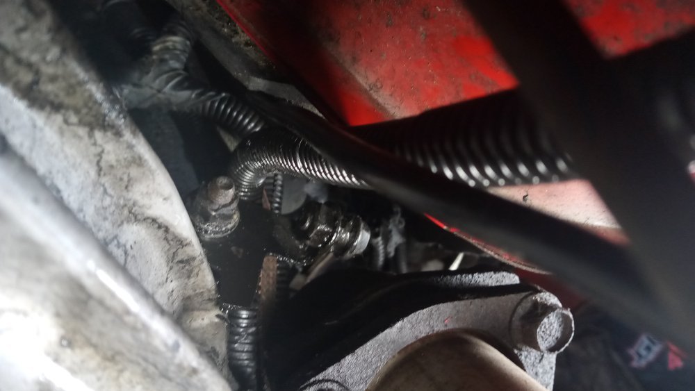

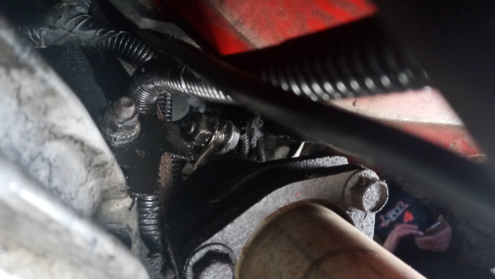

This is the brace that the back of the starter heat shield bolts to. I didn't remove the bolt. Just loosened it. The nut welded on the back takes a 15mm wrench.

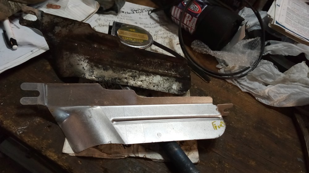

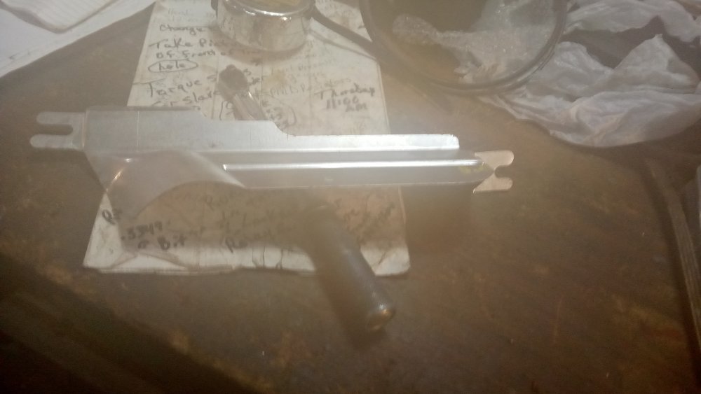

That's a good photo. Thanks. My original has the tab broken off too, but it was the rear tabs that fasten to the little bracket. Has that been sitting around a while or did you recently acquire it? I'm assuming it's the 10191184 mentioned above.

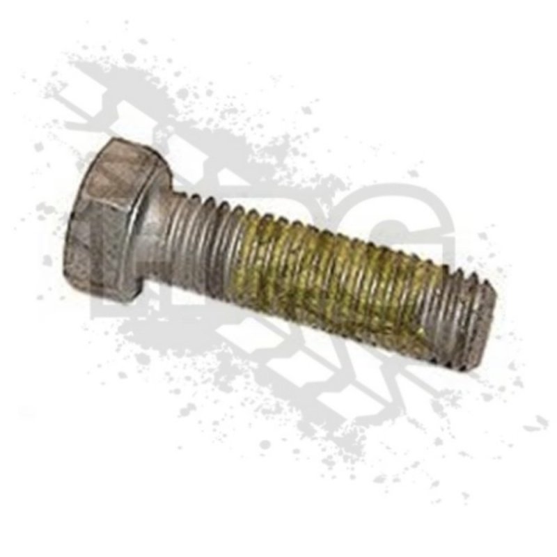

...and then back to the bell housing bolts, I ran across these - 11561121
They are 1-3/16" long on the block side (30mm).
The others that @DieselAmateur linked appear to be 40mm and I think that is too long. I was able to thread a long full thread bolt all the way in tonight and found that 1-3/8" is about the maximum length of threads that were no longer exposed.
Yep, that's the correct part number.
It's been sitting for quite a while. Many years

I think these are the correct length that you showed earlier. I could live with the 30mm I found, but a few more threads would be better. 34mm=1.34" which is about perfect.
