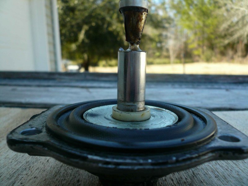

As far as the '91 Dodge Cummins 5.9 that I own... I had that injector pump all apart and I did not see no "aneroid". I saw a diaphram acting on a fuel pin.
That is an aneroid. An aneroid is a diaphram actuated fuel limiting valve, but is called an aneroid for short.
