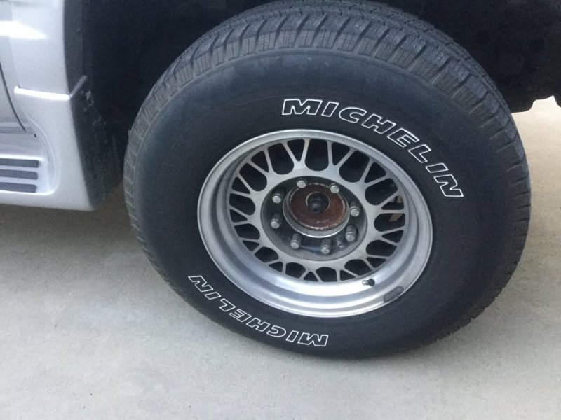

Here is a shot of my 95 diesel suburbans lugs. Dave PO of my diesel Tahoe told me if my Suburban is 8 lug that is has the 2500 breaks and should have the 2500 frame also he said the rear should be different though. Can anyone tell me how to find out which transmission the 60 or 80 I would have?

All the 6.5 diesels had the 4L80E
X-2. The RPO code will verify.
