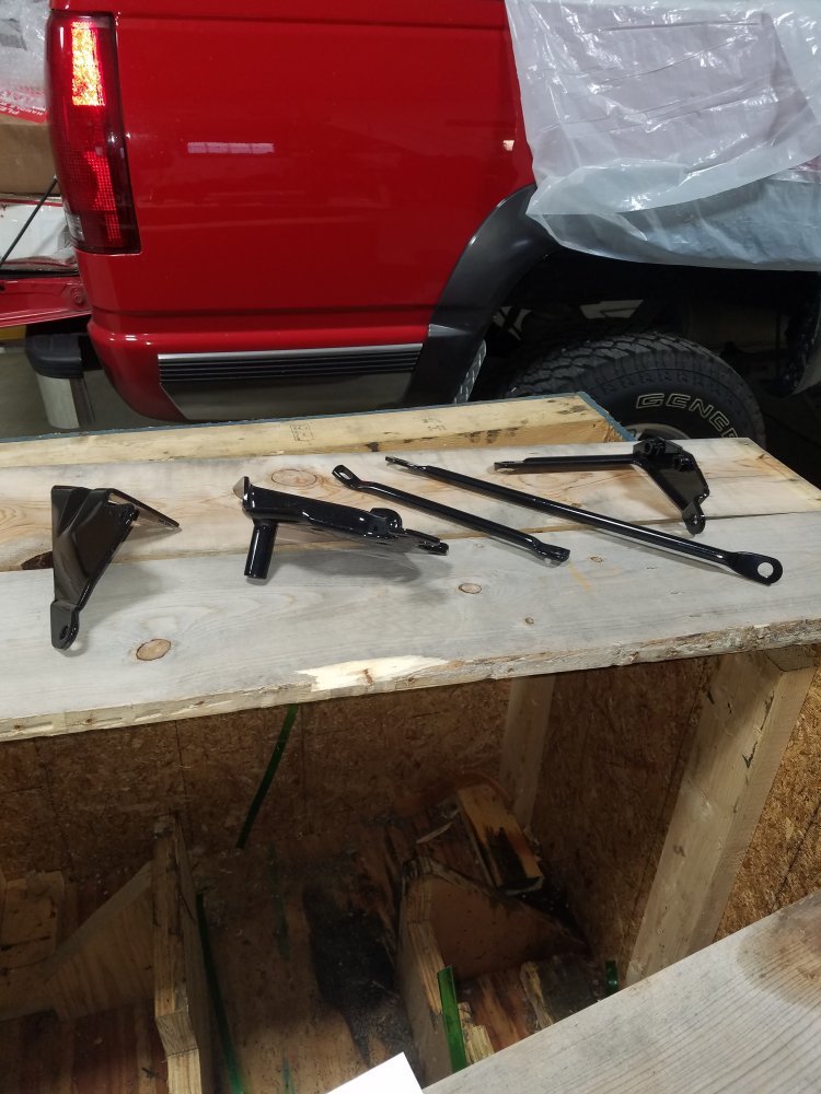

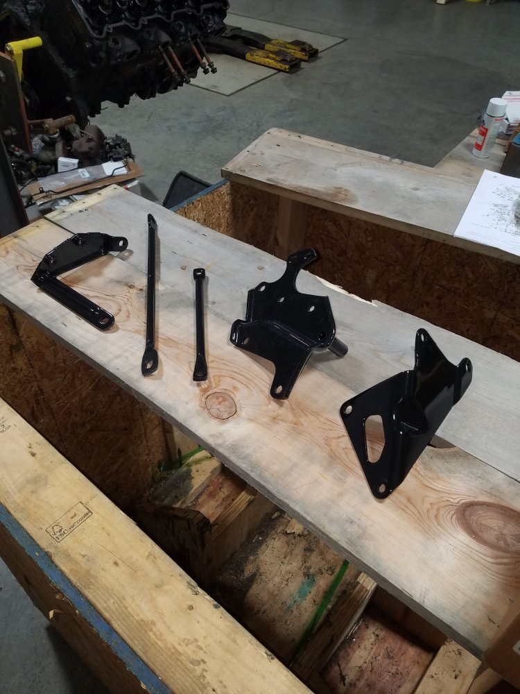

SnowDrift Ultra Conservative. ULTRA! Messages 3,076 Reaction score 3,824 Location Central Ohio map dot Nov 24, 2023 #1 I don't know where these go. I have figured out where the big cast brackets go, but don't know about these. One is for power steering pump I think. Any hints would be greatly appreciated.
G Glagulator GM diesel junkie Messages 73 Reaction score 215 Location very south Texas Nov 24, 2023 #2 The long rod is the turbo brace, the short one goes from the hat to the turbo. Attachments 94-95-Brkts-DRVR.pdf 224.5 KB · Views: 5 94-95-Brkts-LIST.pdf 241.6 KB · Views: 3 94-95-Brkts-PASS.pdf 292.5 KB · Views: 4
SnowDrift Ultra Conservative. ULTRA! Messages 3,076 Reaction score 3,824 Location Central Ohio map dot Nov 25, 2023 #3 Outstanding! Thank you!
Twisted Steel Performance Anything worth doing is worth overdoing. Messages 4,041 Reaction score 7,775 Location Pauline, SC Nov 25, 2023 #4 Top pic, far left - top alt bracket Top pic, far right power steering rear bracket
