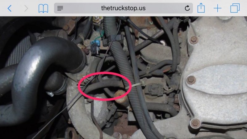

The fuel return line (hose) you replace with clear tubing is out the front top of the IP is a 1/4" diameter rubber hose 3"-4" long. Circled in red pic#1.

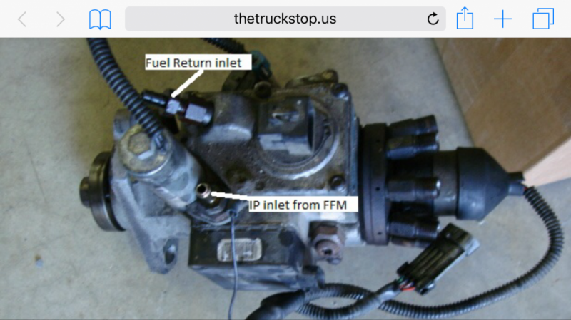

This is the fitting on the IP it attaches to labeled here as "Fuel Return inlet" (I believe it should be labeled as outlet, not inlet as the fuel is leaving the pump).

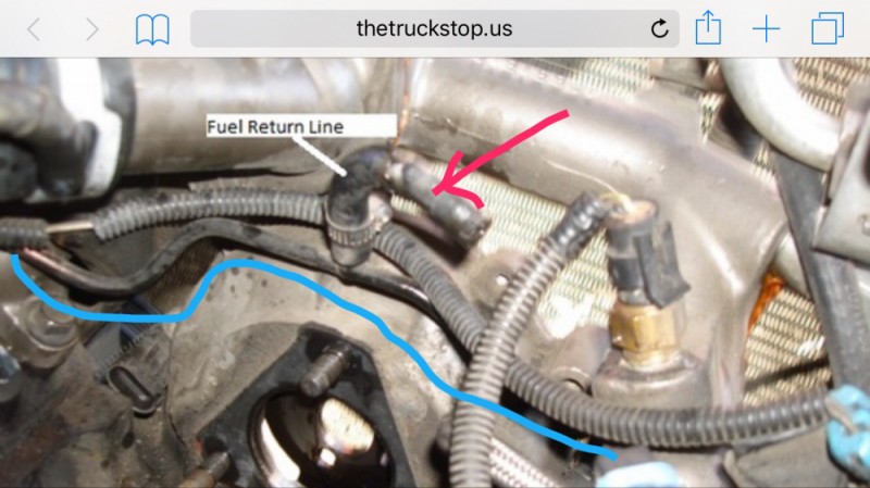

Here is a pic with the IP gone, you are replacing the "Fuel Return Line" with red arrow point at it. It attaches to the metal line that goes from driver side injectors and passanger side injectors that is underlined in blue.
This is also an important line to know and be able to reach in case of failed fuel solenoid . You can make the "loop" larger if needed. If your key will not shut off the engine, this is the line you pinch shut with pliers (or if tubing is soft enough for fingers then great!)

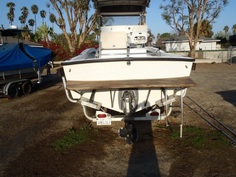

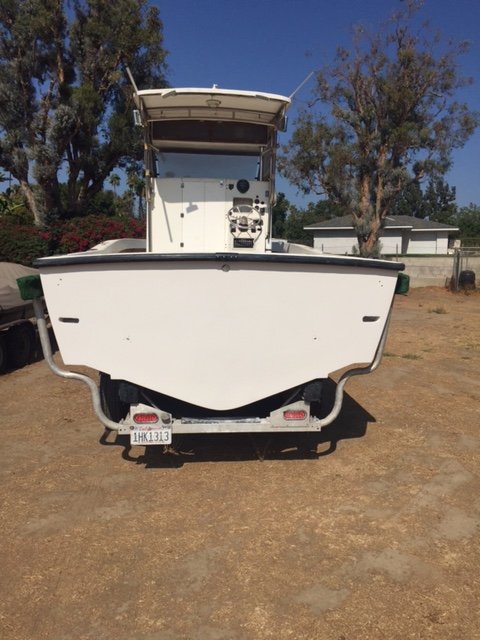

Finally, the boat that's being repowered is back in my yard with a new cleaned up transom. The port side fuel tank was already drained, as that was my source of water in fuel which lead me down this chain of events. I drained the starboard side through the funnel filter and got ZERO water for 35 gallons. Just my luck that I first drew fuel out of the tank that was contaminated with water.

I like that boat, nice deep V on the hull too.
It's a Conch 27. Pretty famous build and very popular in the Florida Keys. 22 degree deadrise. Still being built to order by R & R Boatworks in Stuart FL. They start at $150K with single outboard power. So you can understand why it's worth repowering, ironically from single Volvo Diesel I/O to twin Yamaha F200 outboards.

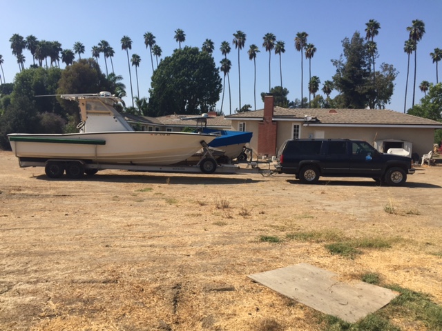

And leaving the worm clamp on the return line while changing the IP is how I dropped it into the cylinder intake port.
