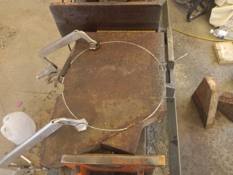

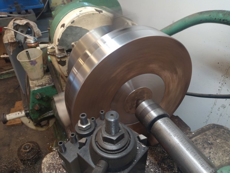

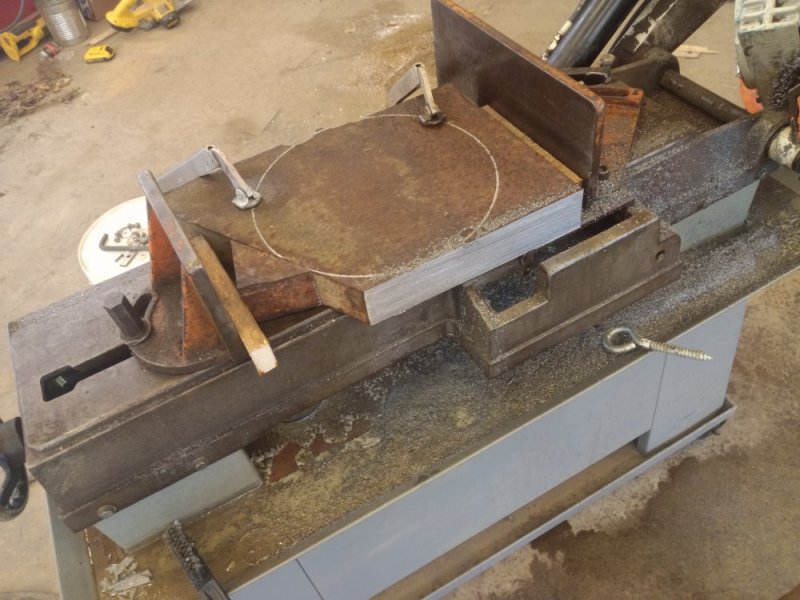

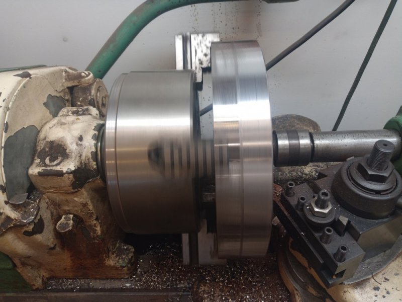

Yeah it's 2" thick and a finish diameter of 10". If it was any bigger in diameter I'd have trouble turning it in my lathe. The saddle won't go underneath it so I have to hang the cutting bit out further than I'd like. I switched it from a 3 phase motor to single phase of the same size and this is the first time I wish I had more power.
