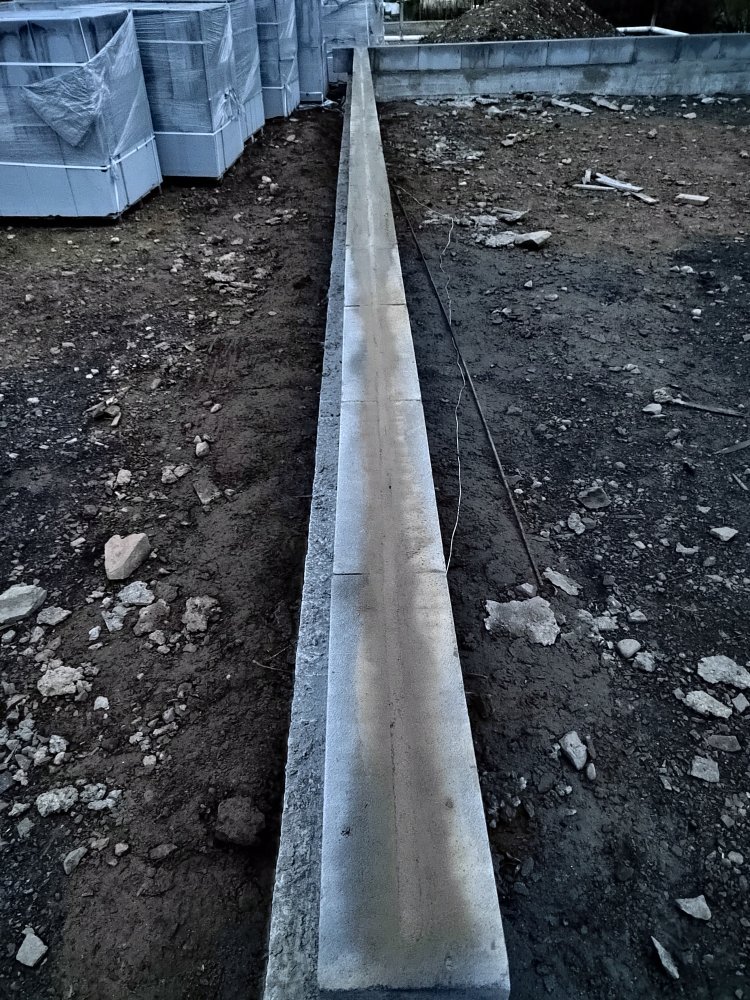

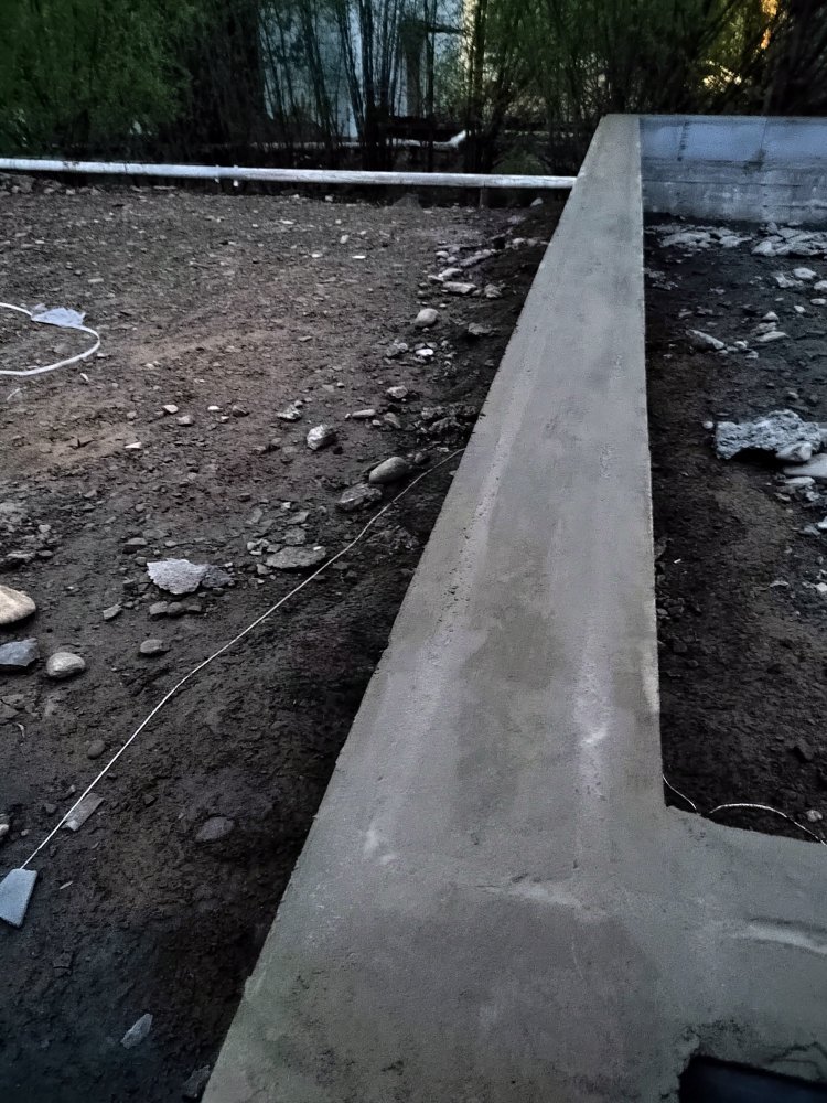

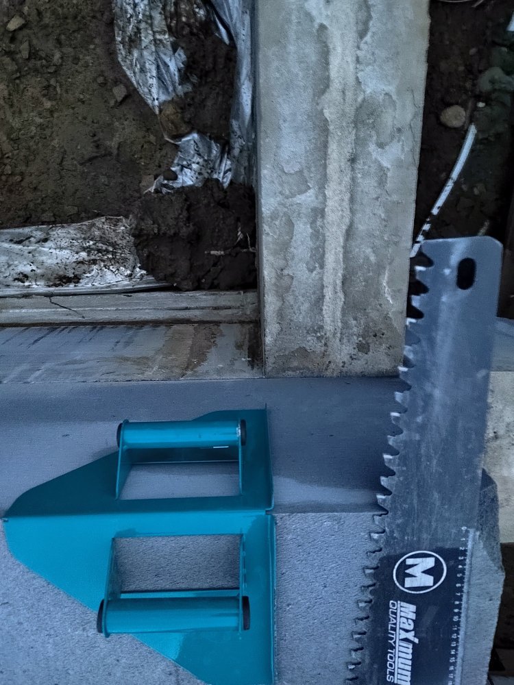

I walled up the reinforcement in the armored belt, 3/8 seemed thin to me, I used 1/2 steel reinforcement. Ffirst filling the groove with concrete mortar, then sinking the reinforcement into it.
Here the rebar (reenforcement bar) would be rigged into it’s location and pour the concrete around it. By cutting the concrete, adding it, then pouring over, the rigidity isn’t as strong because it ow relies on the adhesion of the two.

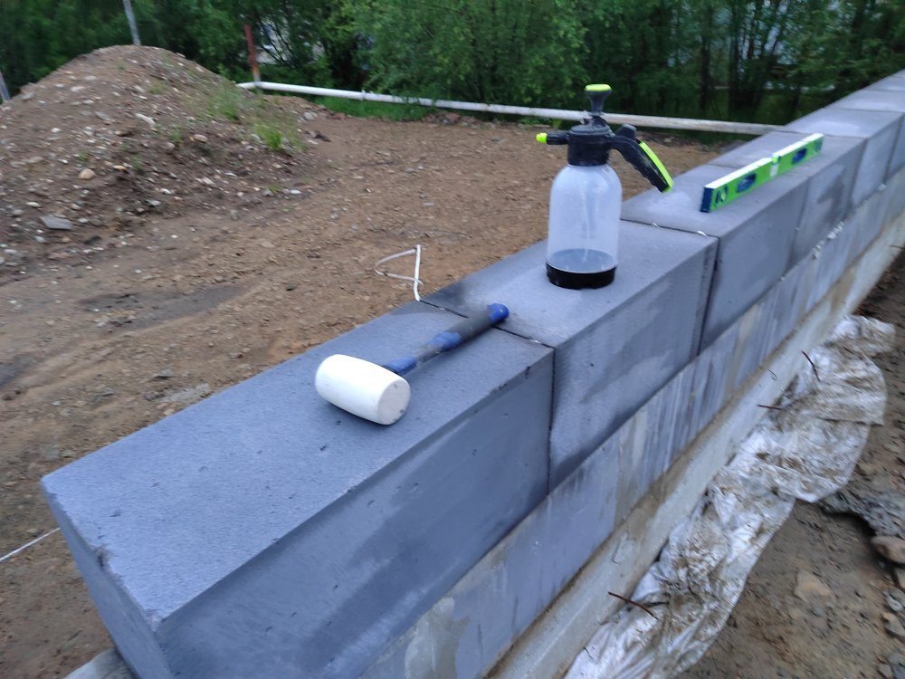

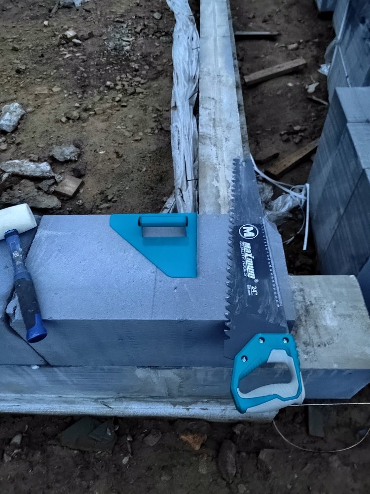

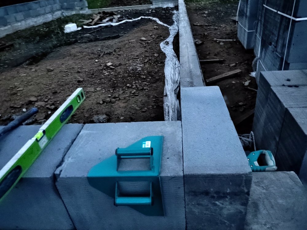

With monolithic concrete, this is how reinforcement is made - and then. concrete. Here, the finished masonry of cellular concrete blocks is reinforced. Without armored belts, lower and upper, it can crack, Therefore, according to the technology of laying walls from cellular blocks, it is necessary to make armoreds in the first row, in a row at the level of window sills, and in the upper row.

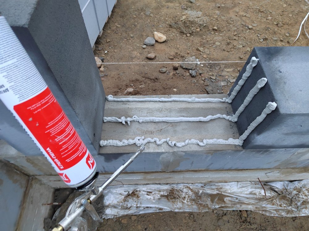

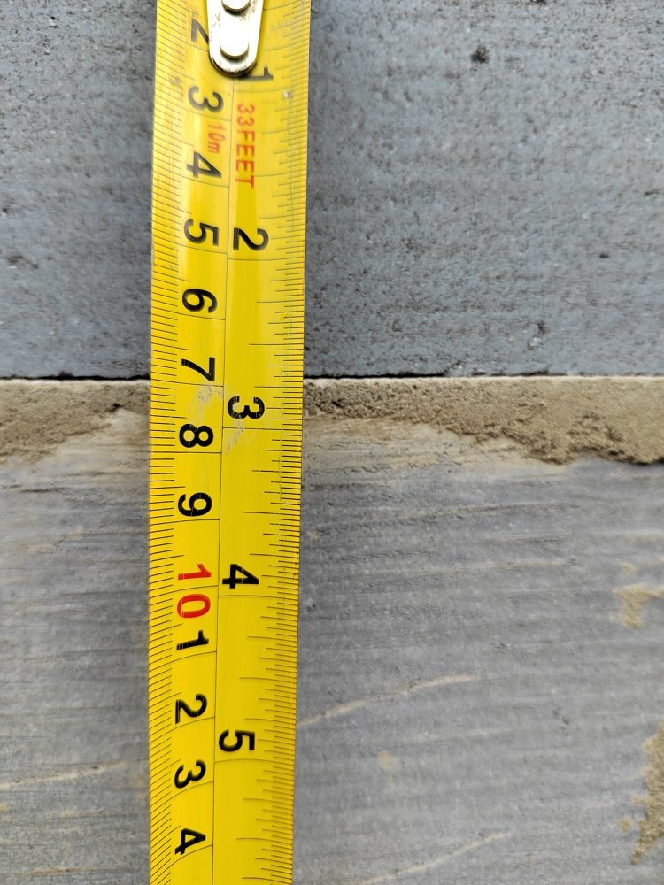

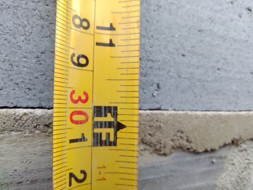

The seam between the blocks is very thin, about a millimeter, the seams will be plastered later, I have never heard about insects in masonry seams.
