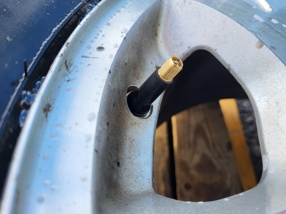

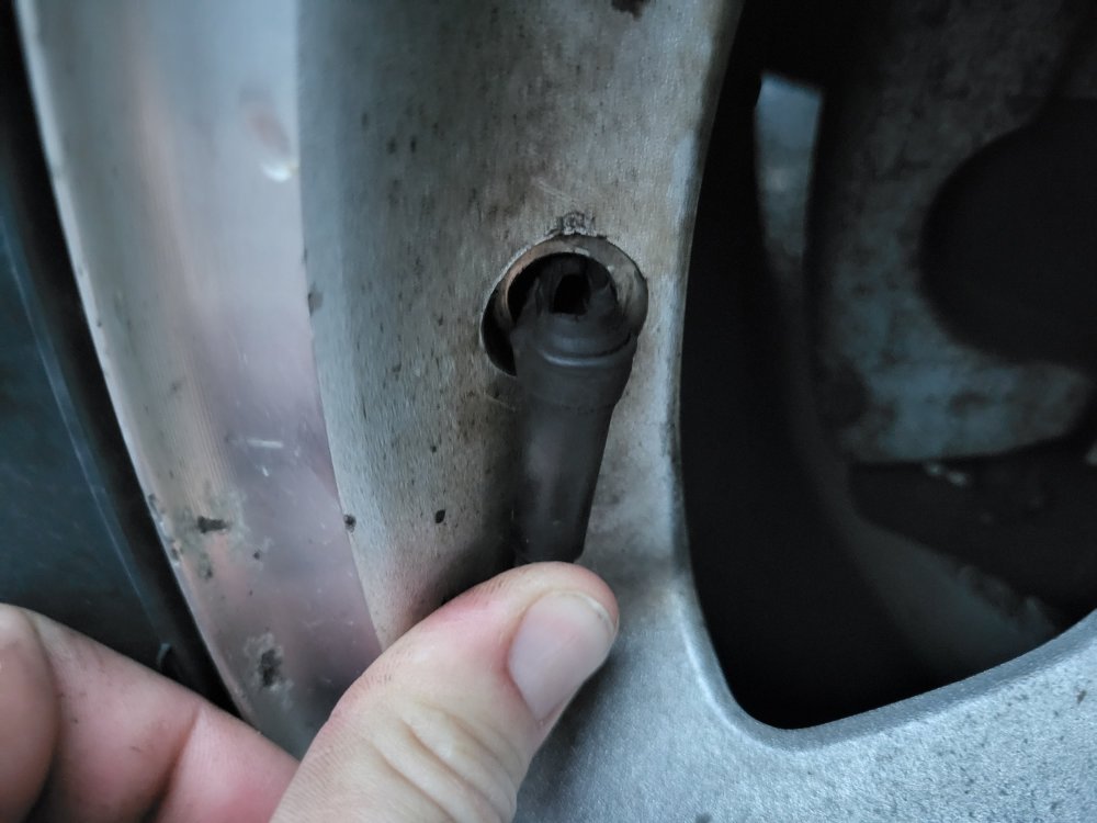

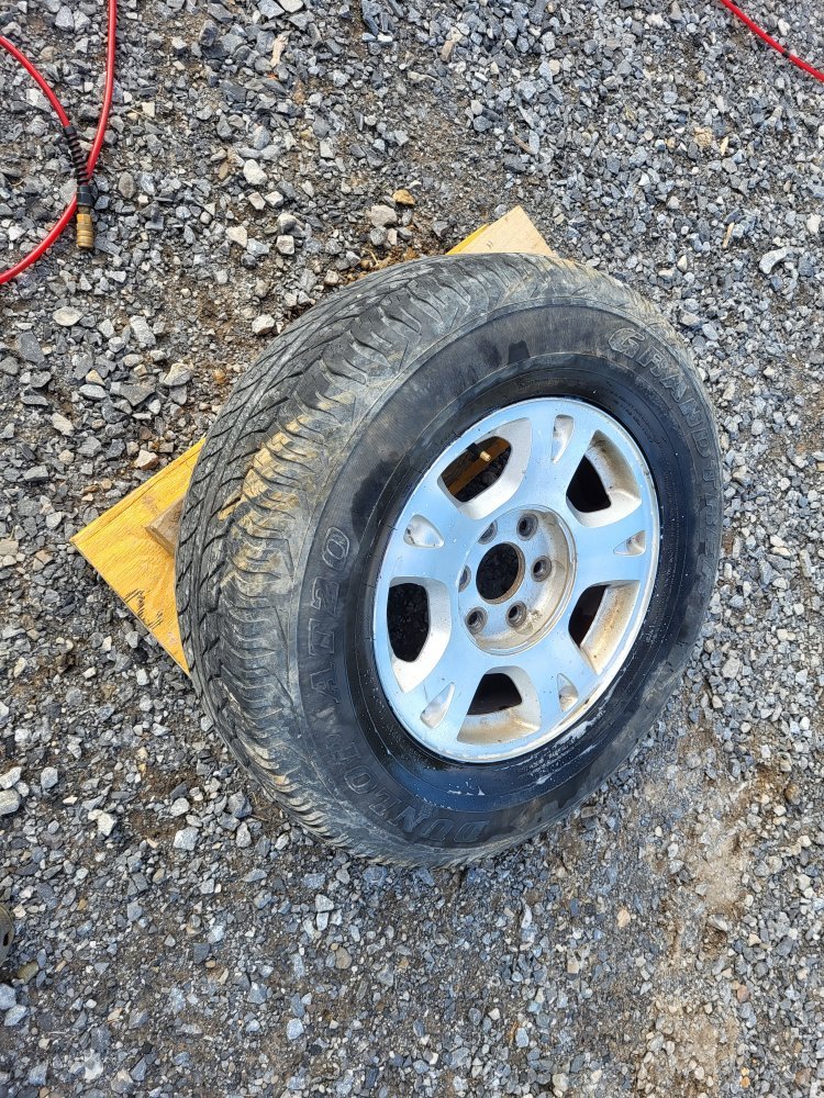

Yukon is still being used every couple of days. Went out for a family dinner and when we arrived home I heard a loud hissing. Turns out the valve stem was ancient.

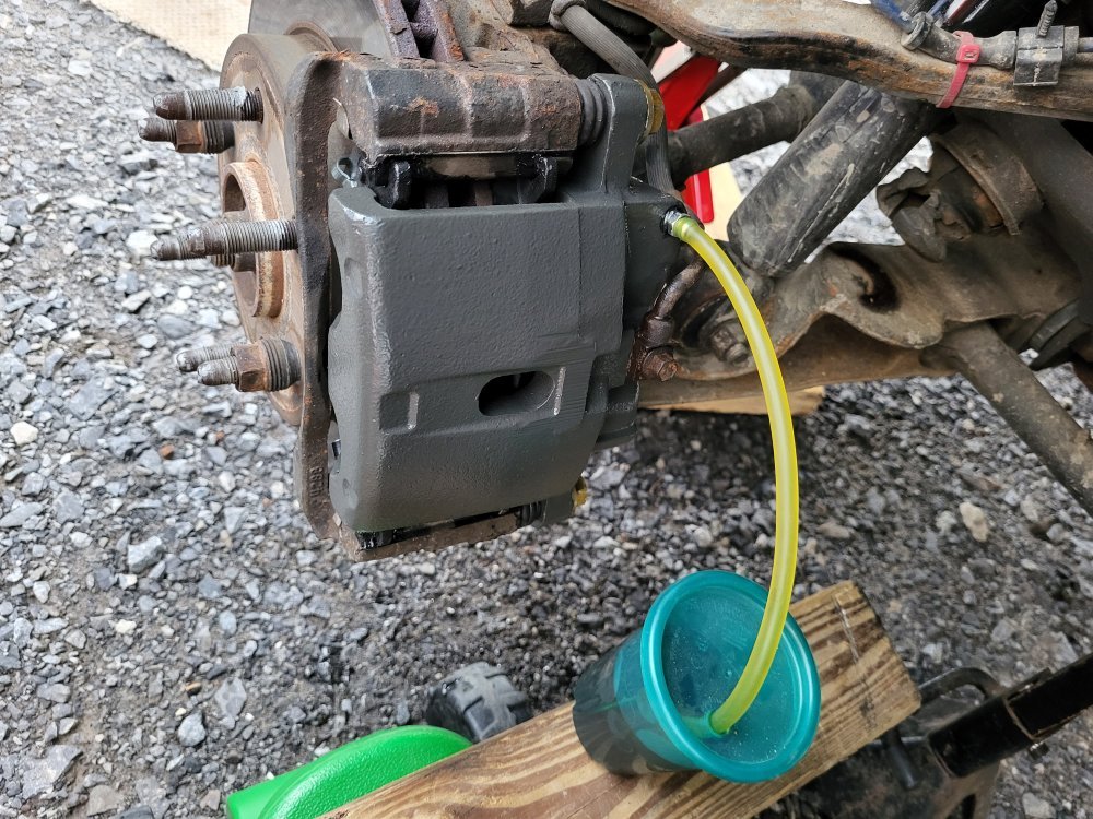

Decided to do some more work in the down time. New front calipers and pads. The bleeders looked super crusty when I last had the front tires off. Eventually I am sure I want them to work.
