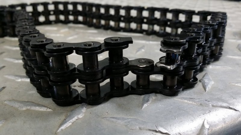

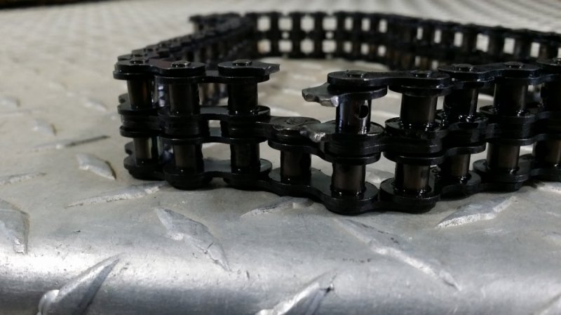

Had a fairly bad engine oil leak, couldn't find it, somewhere in the front. Figured it was the pan, dropped it and the front diff. Found the pieces in it, had a small stroke... Cleaned it out, resealed it & bolted it back on. Ironically, the break in the chain was at the 6 o'clock on the crank. Saw it immediately.
That's where I began tearing into the front of my engine. Turns out, I'm sure the leak was from the quarter sized hole in the cover from the chain...
So how long do you think you have been running the engine wih the broken chain? Guessing it had to be a while to have had an oil leak bad enough you just dropped the pan trying to find the leak...
Been thinking about it. I have never seen a 6.2/6.5 break half the chain. Usually the whole thing pops.
Then pistons bend valves, sometimes breaking off the head and taking out the block and head. Has anyone here ever snapped one side of the chain before in a Diesel and not the entire chain? Really thinking this is 1 in 10 million thing here.

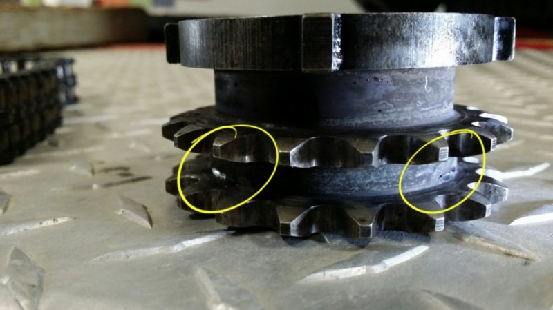

I'm guessing it had to have been like that for a while. Could've been weeks or months maybe even years. The way it wore on the cover to me indicates it was loose. Really only wearing on one side, the return side of the chain not the driving side... And it appears that only the inside half of the chain wore on the cover, until it broke. It wore some pretty deep groves in the cover. Maybe 3/8"-1/2 deep. I'm positive this was caused by severely stretched chain. And I'll grab a lottery ticket on the way back from getting the new sprockets.
