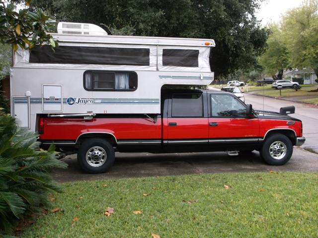

To come full circle, my vote is to go with the load E's and then pressurize them first to the weight rating and then to personal comfort. Intuition is telling me that with the camper in the bed, you will tend to work your way up toward 80 psi in the rear and at least 65 in the front.

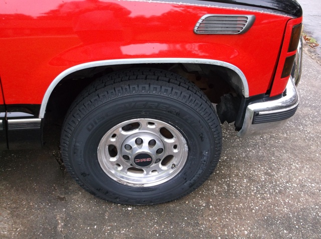

I did end up buying the Cooper HT3's for the CCLB and a set of Cooper HT's for the S10. They are actually ordering them in today, might be a couple days before they are here.
HT3's wound up being $104ea for 235/85/16
HT's were $76.50ea for 235/75/15

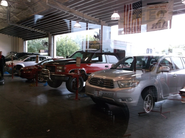

Got the new tires on today. I was so happy I did a power break in their shop. When I let off the break the front wheels came off the ground.

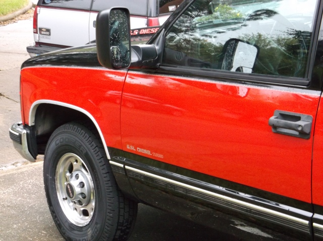

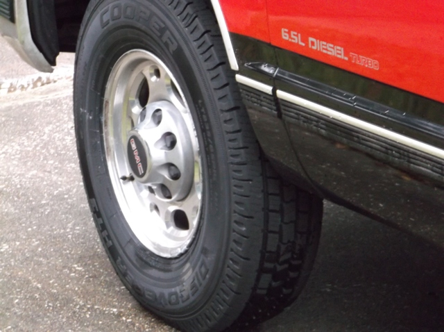

Biggest difference was how much quiter these are, but to be fair the old tires were an AT tread these HT3's are a HT.
I put a set on wifes Subbyrue Forester and since then Cooper get first look for my other vehicles. I like that they are USA made too!
Cooper tires are worth 30-40K miles. I ran Discoverer H/T on the burb. I also ran the SRM Radial II commercial tire on the 1993 and liked them for towing, but, they may be discontinued. Actually they are just renamed Discoverer HT3 so an excellent choice, but, still 30-40K and done.
