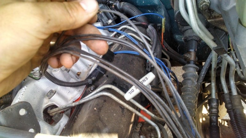

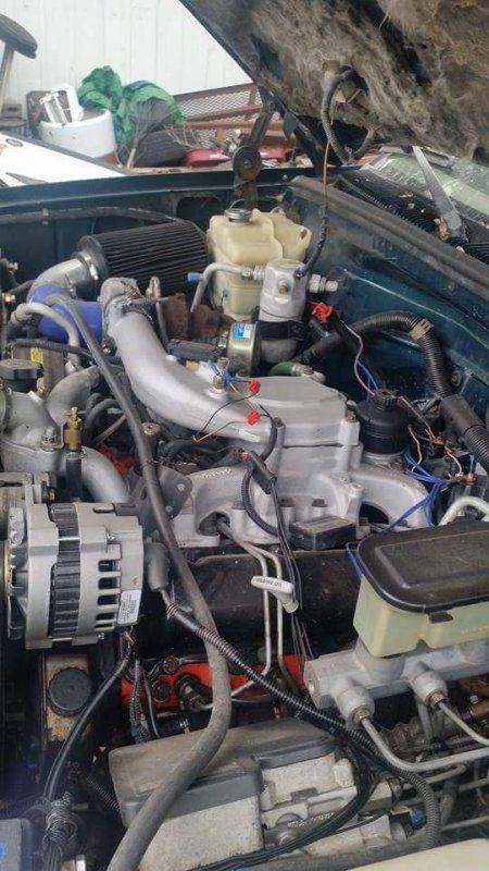

Ok this truck came up for sale locally. It has just came from the local butcher, I mean mechanic, with a reman engine, tcase, and torque converter. Its a 95 K2500 looks like its been run hard but price isnt bad.
Power seats, 2 capt seats with solid center, power windows and locks, heat, ac, and radio work.
Bad: Mirrors are both broke, truck won't start by turning the key it takes jumping a couple wires, under hood looks like a splice job from hell.
Expect the front end is shot, questionable engine parts, gotta plan on exhaust turbo pmd kit and oil lines
Any pointers? Make heads or tails of the wiring and starter issue?

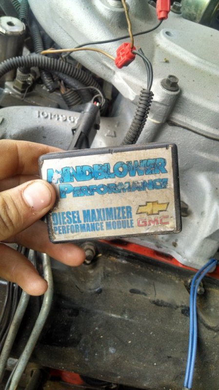

Seriously a soldering iron and replace the corrosion prone scotch locks. The glow plug re-wire is a firetrap waiting to happen with no fusible links. Check that the heat shields are in place as the turbo is missing one. Electrical will waste a lot of your time and more so if it has intermittent issues. May be best to convert it to mechanical and a stand alone 4L80E controller or handshaker mod. The black box sitting loose on the intake manifold driver side is what again? Maybe the truck is a parts truck?
I want a 4l80 runner so I have a reason for having a built 4l80. For 1k I figured it wouldn't hurt to have a go at it. I have a rebuilt 6.5l IP and lines on hand but will need the pedal and wires Leroy's controller.

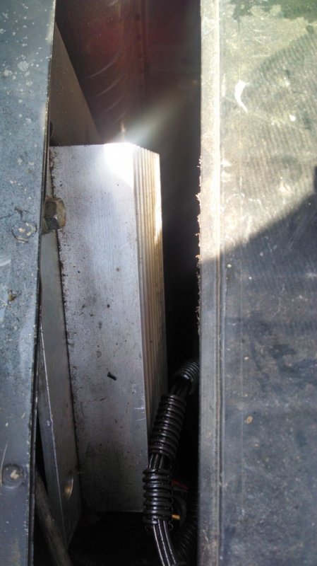

Poor ol girl... Someone started modding right: key on fused lift pump, battery bolts, 0 batt cables with sealed ends, engine runs good once running, pmd relocated (behind battery), but then things went down hill...

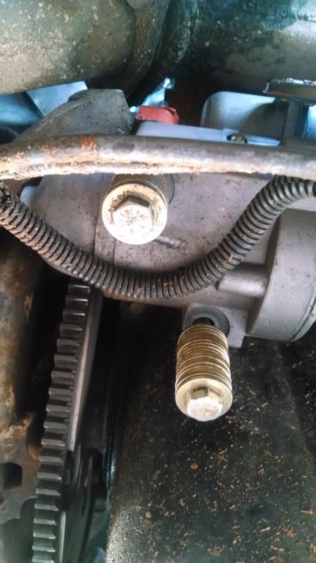

I was generous and offered 500 if my correct starter bolts from my cracked 506 fit then I'll take it. He said bring the bolts!

Missing at least one intake manifold bolt and fly wheel dust cover. Need washers? Seriously?!

Its pretty sad to see the way the engine was set up.
