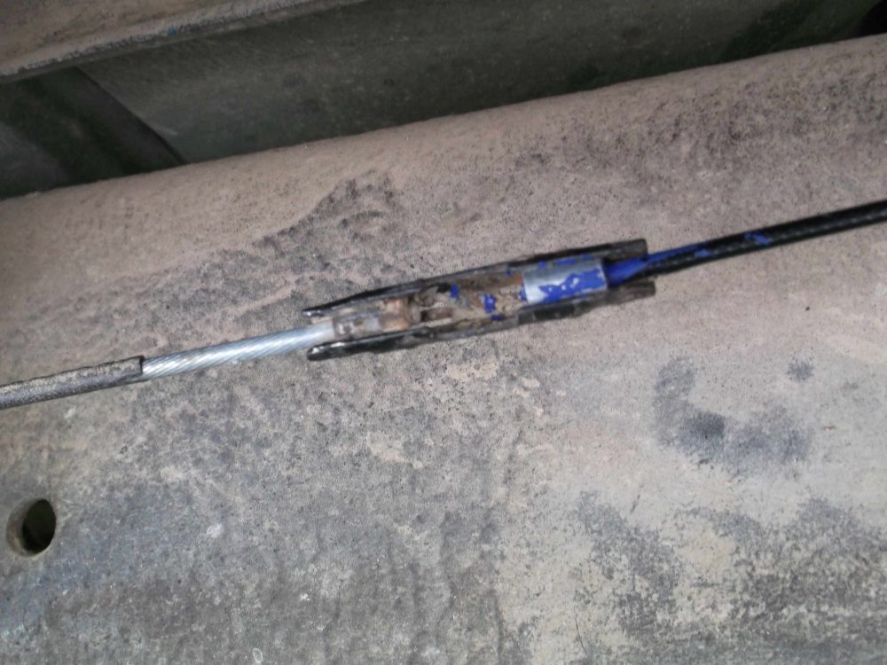

OK Guys, we are near the end of this issue, I have learned a lot about parking brakes that I did not actually wish to know! ;-) such as There is no adjustment for the force applied to the rear shoes, totally controlled by the length of the cables, and my 155" wheelbase requires 83 7/16' cable for the left rear drum. The AC Delco one I ended with was 1/8" short of that but it works Fine. The cable is for a crew cab and a cab and chassis (which mine is).

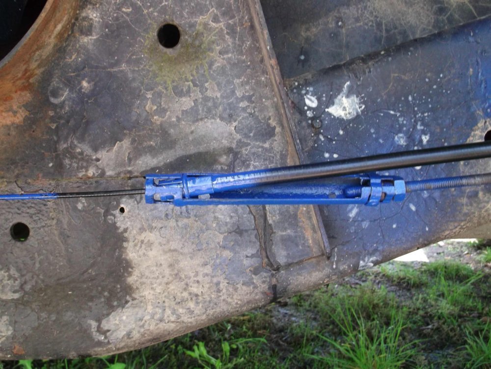

I adjusted the equalizer so when the parking brake is 'on' there is no slack in the cable... but the left side will lock up the drum and slide the tires in the gravel when the parking brake is lightly applied. The right side will not slide the tire ? Is this normal I can not get it to slide no matter what I do with the eq. adjustment.
I posted some pix of the final assembly.
I will have to look at mine and see where and how the two cables join each other and connect to the single cable heading to the pedal. I thought there was an adjustment somewhere there to allow it to pull on each cable equally. make sure that both adjusters in bottom of the shoes are adjusted the same, both drums have the same tension or using the same rotational force to turn by hand. that alone can make all the difference.
