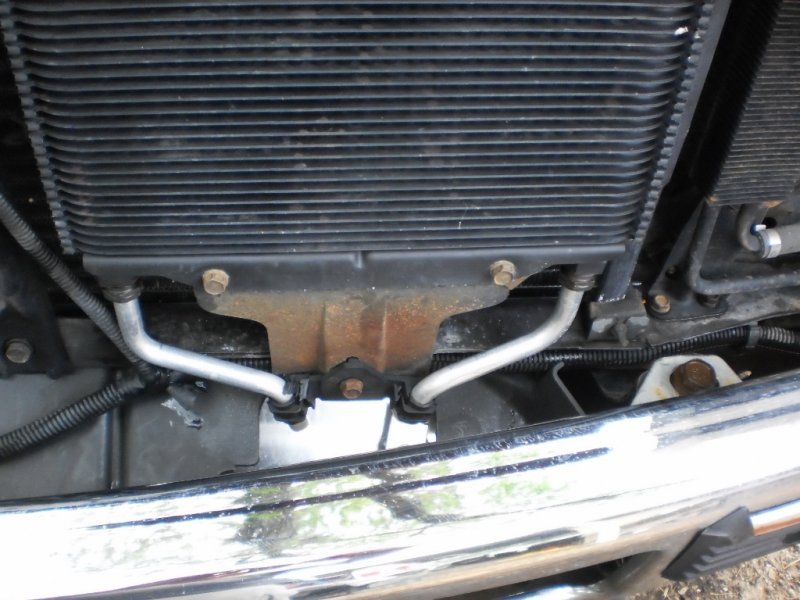

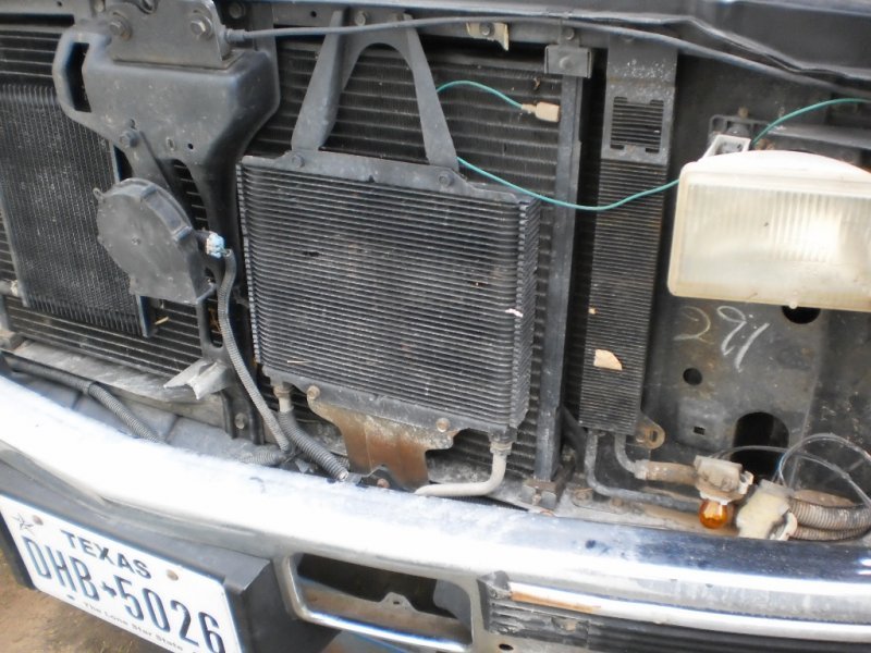

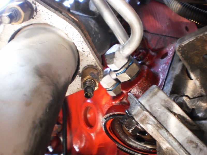

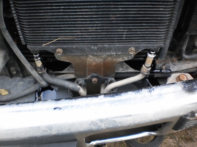

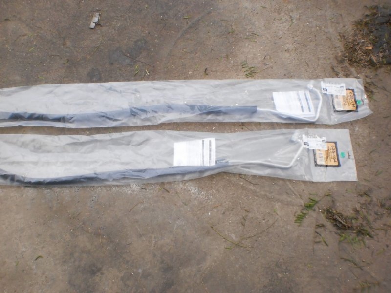

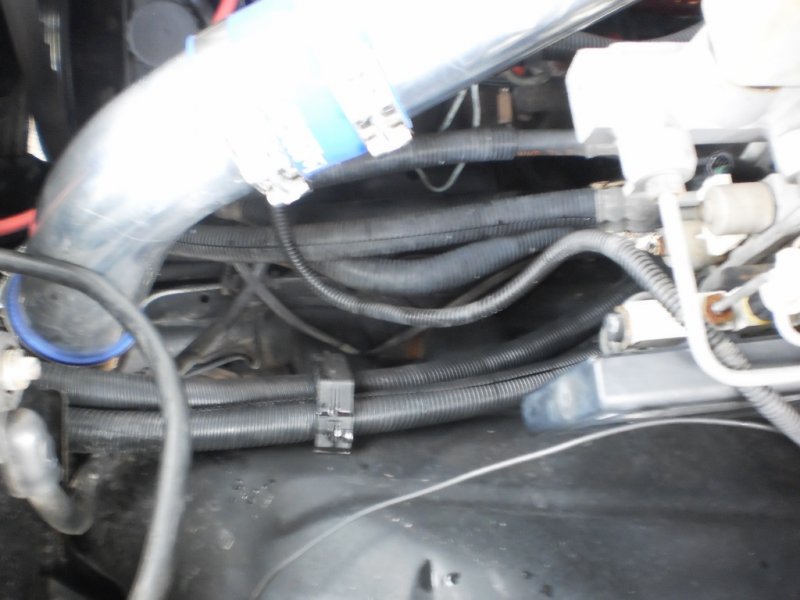

Here are a few pics of my oil line install. While I had my truck up on the lift, I noticed my drivers side valve cover is stating to leak from the back. :mad: Its really my fault, as I used the regular black silicone to seal it, when I should have bought the Right Stuff. No big deal, as I'll be replacing my IP, and injectors soon, so I'll take care of that at the same time.

I'm saying the clip failed and killed the engine. I had read about the issue and double checked that they were installed right. It also was the second set I had replaced on the truck(first set when I got truck), cause they (oem lines) don't last long before they start weeping oil. I've had this truck a long time. My girlfreind still thinks I did this on purpose, to put the engine I wanted in there, like I have thousands of dollars for sudden engine swaps. My Datsun still has no racing engine in it cause of this mishap. I am happy with my swap though and done venting now.
There was a recent thread where someone had there stainless lines routed near the crank pulley and it wore through. Pics were included. I was outside at night, flashlight in hand, making sure mine were not like that. Forumitus is real.

I know that had to sting Rob. Ouch! I have a question for you. When installing your lines did you install the clip after pushing the line into the fitting, or did you install the clip first, then just snap the line into the fitting? I ask this because GM has been using this type of clip for a long time, and the only time I ever had a problem was at a garage I worked at about 15 years ago. We had a trans flush machine that required taping into the cooling lines, and of course GM uses a smaller version of this same clip on the trans lines. On one car I was working on, I installed the clip with the line already on the fitting, but I apparently didn't get it quite right, as mid flush the line popped off! What a mess. Anyway, I started installing the clip first, and popping the lines on after that. Never had another problem. Of course I always checked the clip even after doing it this way. I was always glad it happened during the flush. Could you have imagened if it happened after the customer left? I would have been in deep doodoo!:D
Matt
Use that IP money for upgraded lines, you won't regret it. Those upgraded fuel mods won't mean anything if one of those lines blow while driving down the road.
Sorry to sound like a broken record but these stupid lines have killed many 6.5s
I found out on my first replacement to put the clip on first ,cause when I put the clip on after, the line could come off. Those stainless hoses got to be simpler to install than finagling oem lines through the MM hole. Although, a lot of the PIA things I encounter wrenching would be easier with a rotary lift. The other plus about the SS lines is that I have no leaks in those areas. The biggest sting from this is that while the truck sat the rear window leaked and rotted out the cab corner/rocker panel. Those holes let in the rodents and they ate the headliner, carpet and velour of door panels. I had to remove the dash and thouroughly destink under there. The positive is that I fixed the blend door issues while the airbox was out. The cab was perfect beforehand. I should be done welding panels tomorrow and have new interior back in by end of week. Paint will have to wait till warm weather returns. My avatar is the usuall sight of my truck, and people are stopping by to buy parts thinking its a partout.

When I bought my truck, it had rodents in it, and although they did minimal damage, the stink was awful, and required me removing much of the dash, and all the carpet, and seats to get cleaned back up. The pic in your avatar is what my truck looked like today. I had the bumper guard, and grill off while changing the lines, and then drove it to the carwash that way, so I could properly clean up the mess. I will say it seemed like the temp gauge ran a little lower that normal with it that way. :)

I always clean the cooling stack when truck in in that state. It always amazes me how fast leaves and weed seeds get in there. Good luck with the new IP.
Thats good advice, and I was very surprised at the amount of leaves I had built up between the condenser, and radiator. I blew them out, but I only installed the condenser less than 6 months ago. It really is amazing how fast trash can build up in there. Here is a thread I did on this issue awhile back. http://www.thetruckstop.us/forum/th...nd-radiator-to-clean-them-periodically.42962/

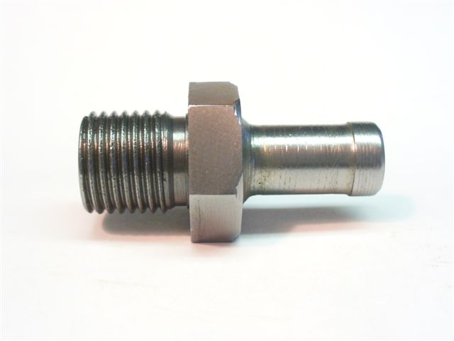

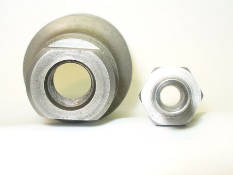

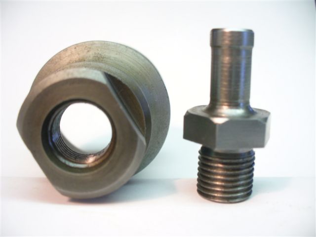

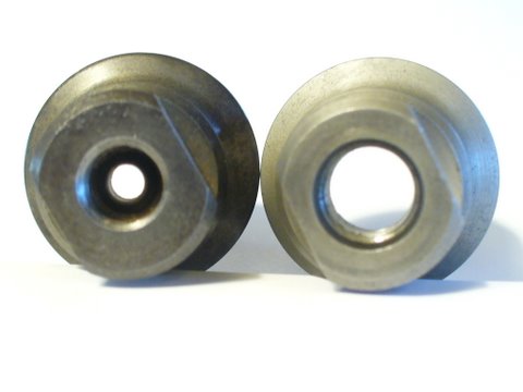

I know I recently said I was going to have Conestoga Diesel build my IP, but I contacted DieselPro to ask him a few questions about my IP, and one thing led to another.. Anyway, after many PM's back and forth talking to him about what I wanted from my IP, I sent my IP, 311 Bosch nozzles, and some core injectors off to him for the performance treatment.
Along with giving the internals the performance treatment, he is also swaping the small GM inlet out for the larger Ford inlet. He then custom made a fitting to allow me to use larger 5/16 hose. It will be awhile before I have the pump back in my possession, but I'm really looking forward to the results. A special thanks to DieselPro for helping me out, and being willing to share lots of really great info. :)
Here the pics of the GM, and Ford inlets, as well as the custom fitting he made. Thanks
Matt

Diesel Pro is a great guy, very smart and has helped me out with parts a few times in the past too.
He is a great guy to deal with, and he helped me out on getting my current pump working better here recently. I'm very pleased to have him handling my performance pump now. :)
So how long is it gonna be before it's ready?!
He's treating me very well, and I told him to take all the time he needed to work his magic. I'm in no hurry, as my current pump is running well, just not enough fuel for my liking. :D
Matt
Perhaps this is a dumb question, but I've searched and can't find the answer....who is DieselPro and does he have a business, website, etc?? Thanks.
