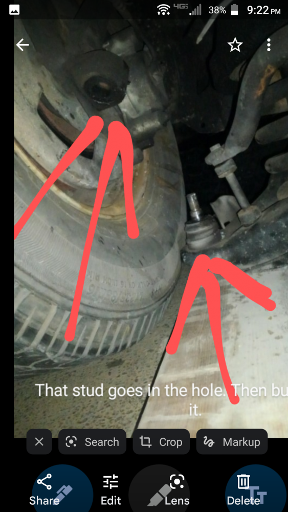

I would normally agree but not in this situation. If the taper isn't holding then no amount of over tightening or fancy washers are going to stop what's happening. It might prolong the inevitable but not stop it, as evidenced by the nut breaking. The nuts main job is to keep the taper seated, not to hold the entire load.

Just welding the top of the unit- welding the nut to the ball joint- yeah that will hold a week maybe. Lock washers are not going to keep it from coming loose. It isn’t road vibration making the nut come loose. The taper is moving around in the seat.
If you can borrow a tapered reamer, that has a CHANCE of fixing it. But if you have to spend $20 for one- I would say no, don’t do it. Cut a bit too deep and now the unit goes in to far.
What you need is the new part and new ball joint.

I think the taper is screwed. I'm thinking a reamer will just enlarge the tapered hole out more yet. To much for it to seat.
I really don't have a clue. But I think new parts are in order. Or good used parts

Stoney, I am saying if you completely lock up the suspension on that side of the truck, then the ball joint would not have to pivot. But this would be a super temporary thing to try because it would limit you to 10-15 mph on perfect condition roads and 1 moh over bumps- I should not have even mentioned it.
@Stoney when you installed the new ball joint, did you fit test the tapered stub into the spindle to see if it has a wobble? does the stub protrude all the way through so where you see more than just the threads poking out the top side? if so the taper in the spindle is toast. if only the threads are what's sticking out and the stub on the joint feels secure with the spindle and only the top side of the taper in the spindle is wollered out, you might get away with having someone crack a weld bead in that area to fill in where it's wollered out, then use a reamer to reshape it smooth and touch it with a flat grinder on the top for the nut.
that may buy you some time until a replacement spindle can be found.

Tapers have been used for a long time to hold things. I have a hammer drill that uses a taper to hold the drill bits. ALOT of drill bits use tapers to hold them. In the machining world tapers are everywhere. The chucks on drills are held with a taper and usually a screw. They're used for repeatable accuracy and holding power. Once it starts turning it will score the bore of the taper or the shank or both and then the holding power is greatly reduced. From what Stoney has described this has happened multiple times and likely can't be cleaned up. Tapers work amazingly well until they slip , they go downhill pretty fast after that.
