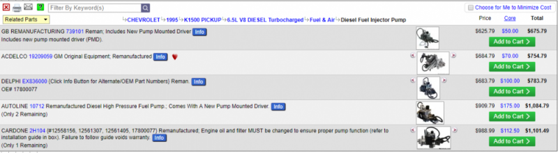

If I go for a new pump, which sounds like the safest bet, are there any difference between these ones or which one should I get.
57692
I would try to avoid reman pumps.
If you are going to spend the cash, get a brand new one.
To many stories of problems with reman pumps out there.
Your housing and rotor may be in better condition than the used one you are buying.
You have to do the computer nonsense wether doing OS or IP, so don’t let that be your determination.
Unless you are allowed to do a change from ds4 to a db2. That is a lot more involved, but best way to go imo.
Eliminate the computer needs all together. There is more than one reason that all the 6.2/6.5 in the military does not use ds4...
More reliable,More power,More mpg,Less emissions
But the problem you might have is how your emission laws are in your location.
Contact a stanadyne dealer for pumps. I used Columbus Diesel here in Ohio. I would never get an injection pump from a major parts place like rockauto or auto zone. Your asking for trouble if you do.
