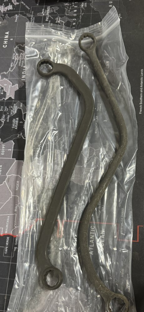

So "Pavel" and I got together today to work on the truck. It was slow-going as the previous mechanic that worked on it had really wrenched down on the IP mounting bolts. Pavel finally was able to get to them after I bought a set of wrap around wrenches from HF--he also had to remove the upper plenum from the engine.
He had previously put his meter on the engine and found that the IP was too far advanced. After about 4 hours of wrestling with the mounting bolts we discovered the the previous mechanic had used Permatex on the IP gasket--essentially making it impossible to adjust timing with out cleaning off all the gasket material, etc. This will involve removing the Intake manifold, etc.. I'm pretty frustrated at the mechanic that did this... what was he thinking?
