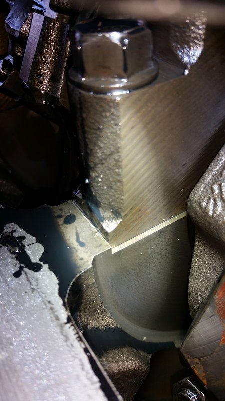

How deep are the pits on the cyl walls? Can it be lightly honed out w/o oversize pistons? Maybe the engine can be saved...
This is an extreme example of why I recommend new rings on military surplus engines, but, I don't know that they get this bad w/o rainwater or blown head gaskets. One of my engines did have some minor discoloration and small pits after 40K and a light hone touch up during an overhaul.
The block is cracked at the main. The pitting could be cleaned up with a bore or sleeve.
