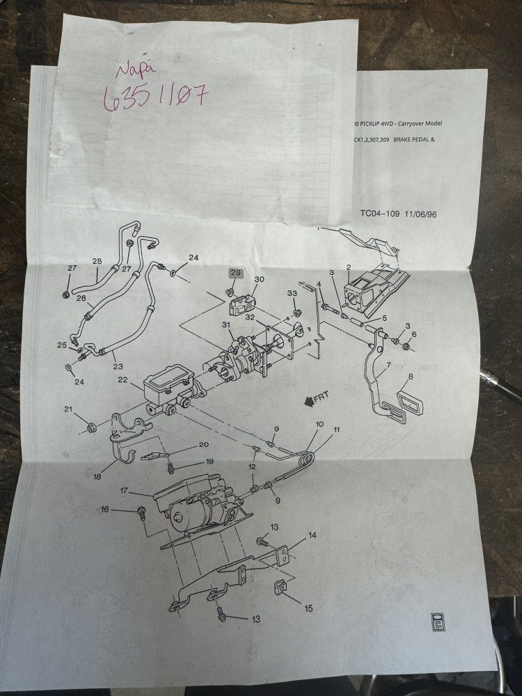

On this 2000 K3500 truck. Got the master cylinder unbolted from the hydro boost and moved away.

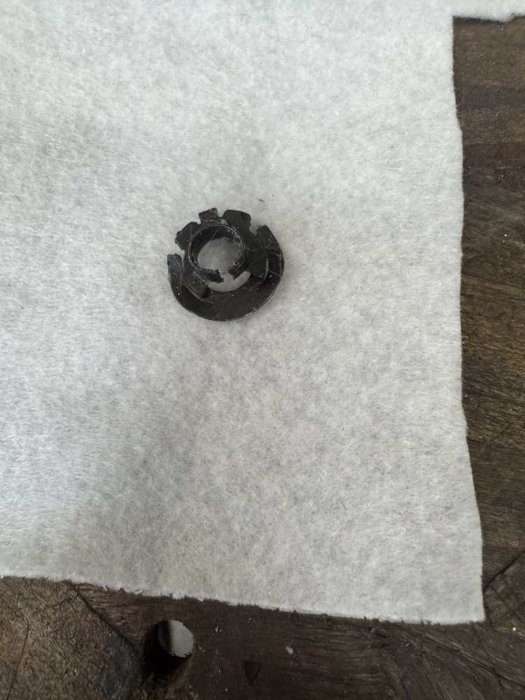

Got under neath the dash unit and the brake lamp switch has this weird looking retainer attached to the pivot shaft nub.
It is not a hair pin style retainer.
This thing looks like a sort of a cap and It fits into a groove in the shaft.
Dont know how to explain it any other way other than it is spring steel and can be rotated on the shaft but there is no openings or seemingly any way to expand it to get it to release.
Anyone ever have to deal with such a clip ?
Please explain the removal procedure. Chiltons book explains it as a hair pin style of a retainer.
Was able to get a long narrow screwing driver into the slice and spread it open, then had just enough pressure to give it a bit of a lift.
Popped right offt. 😹😹😹😹
Seems to be in okay condition but I’ll have an excuse to go for a Harley ride and buzz out to the dealer tomorrow and see if they have any such a critters on the shelving.

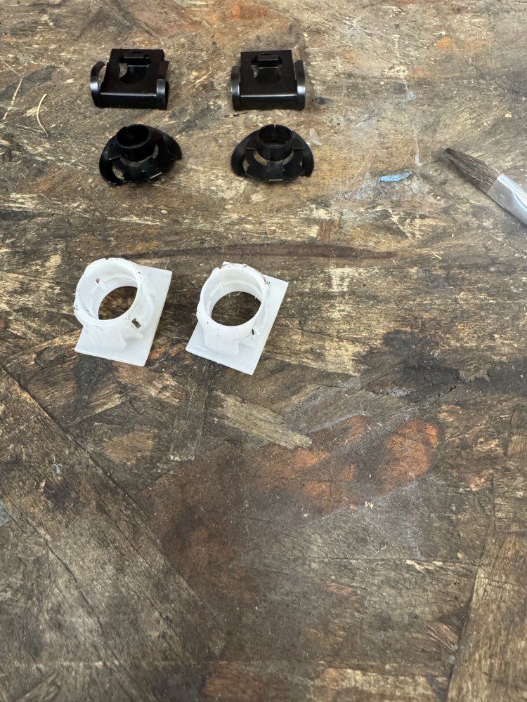

Idk why GM kept changing the design of these clips. the one on my 95 had a flat piece that clipped over the end of the shaft, you had to pry it up then slide the clip to pull off the shaft. and to do that all with one hand. there is just barely enough room to get one hand in the hole between the dash supports. once your hand is in there you can't even see in there and have to feel your way around! not an enjoyable experience. there's other things I would rather "feel" my way around at LOL 🤪

I have rebuilt 2 of the HB units with the kit from Pirate Jack https://piratejack.net/hydro-boost-rebuild-kits/ one thing you have to watch for is correct rod length, and config of your HB some have a threaded rod end, and others you have to cut and reweld back after the rebuild, depending on vintage of hydroboost, if getting a reman confirm correct length if rod is too long or too short (BEFORE INSTALLING) you will never get brakes to bleed/function correctly.
Ask me how I know, fiddle with that clip only to find the hydroboost you just installed was the wrong configuration. Grrrrr
For special tools you need a 16mm 6pt 1/4" drive deep-well socket and 1/4" drive long extensions with universal joint on socket, to make it a little easier, and I mean just a little easier, for the 4 mounting nuts/studs.

Yup. I seen in this one site that sells hydro boost units and a lot of other brake related components that the have listed a long and a short master cylinder rod.
After seeing that I looked at those two offerings.
Mine is the short MC rod. The long rod appears to extend beyond the boost unit an inch or maybe more.
Then I figured I better check the brake pedal rod and those both were the same length.

In order to get that little hat trick retainer back on I used one of those square shank Snap On pry bars and was able to work the bar into a position that I could pry that little trouble maker onto the nub.
