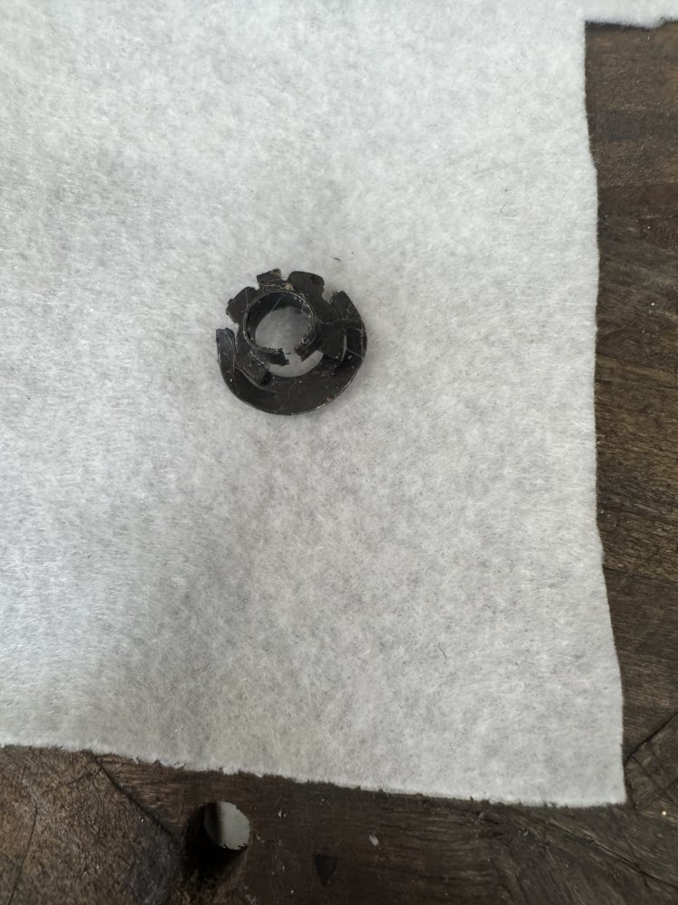

Got under neath the dash unit and the brake lamp switch has this weird looking retainer attached to the pivot shaft nub.
It is not a hair pin style retainer.
This thing looks like a sort of a cap and It fits into a groove in the shaft.
Dont know how to explain it any other way other than it is spring steel and can be rotated on the shaft but there is no openings or seemingly any way to expand it to get it to release.
Anyone ever have to deal with such a clip ?
Please explain the removal procedure. Chiltons book explains it as a hair pin style of a retainer.
Was able to get a long narrow screwing driver into the slice and spread it open, then had just enough pressure to give it a bit of a lift.
Popped right offt. 😹😹😹😹
Seems to be in okay condition but I’ll have an excuse to go for a Harley ride and buzz out to the dealer tomorrow and see if they have any such a critters on the shelving.

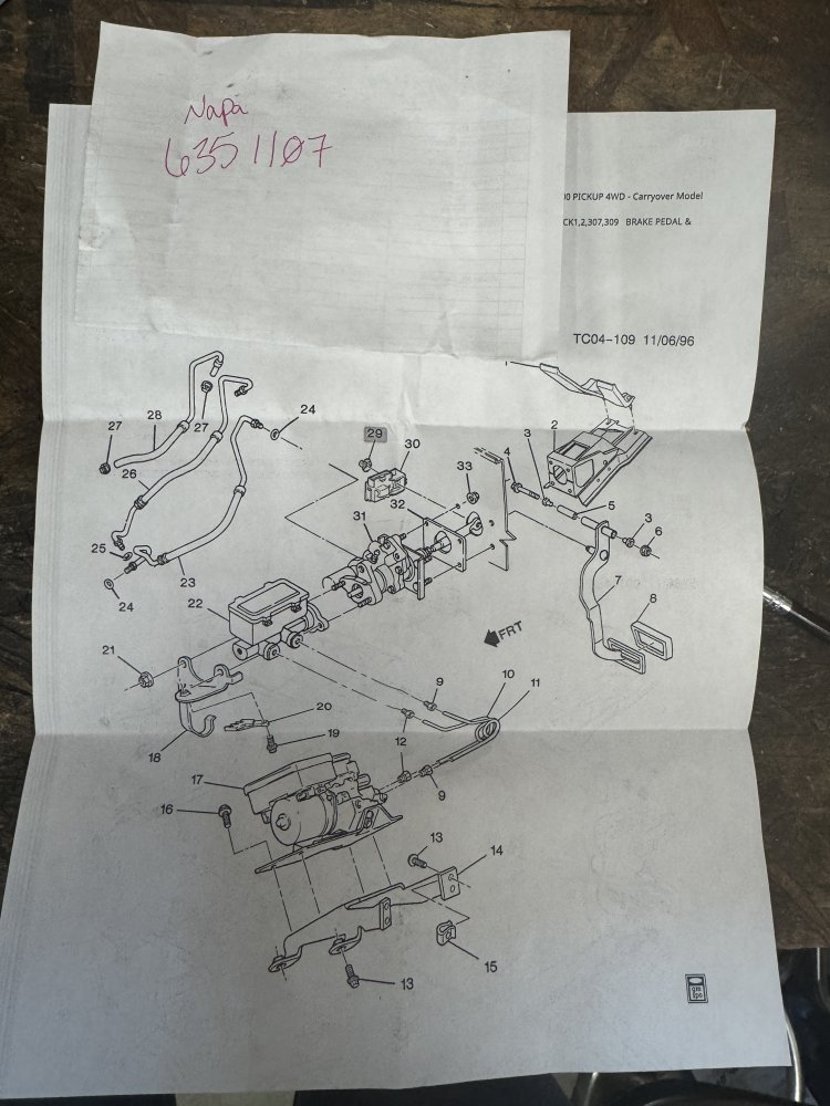

New boost unit is in the hole. Tightened, lines connected, brake rod threaded over the peg.
Ready to fire up and see if this nice commiechinesium unit is going to live or die. 😹😹😹
I did find a source for the accumulators for about $75.00 and the core for my old unit is a whopping $16.00 so I’m keeping this. I’ll source one of them chinesium seal kits and one of those accumulators and kit my old unit for a spare.
If this chineseium unit fails within warranty period then I’ll send it back to NAPA, tell them to credit my account and then go with My own rebuilt.

In order to get that little hat trick retainer back on I used one of those square shank Snap On pry bars and was able to work the bar into a position that I could pry that little trouble maker onto the nub.
