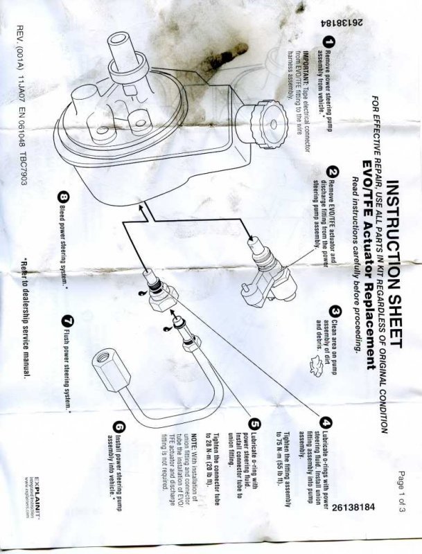

Here is the sensor you are looking for IF there is on on the back of the PS pump. It would be hard to see for sure. Looks like people replace complete pump with one from a 1996/1995. (New or junkyard at that vs. trash rebuilt.) Diesels may have different pressure springs in the pump vs. gas engines w/o hydroboost.
Alright, I reached down there on the pump and there's no EVO, just the tube coming out. Took a photo using the iPhone, but can't load it here. Can't even find old photo albums with this new forum software.
I saved some manuals over the years, but wow, a kit instruction sheet! Your kinda scaring me pulling that out.
I got more of those than I like with all the PS pump swaps I did on the 1995.
