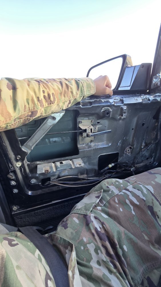

IDR all the procedure but one orocedure I do remember, take it to the body shop if motor/channel units nee replaced.
I would pull door panels but for some reason the process of pulling motor and channels was always more than I liked to mess wit. 😹😹😹😹
Well, actually got that sorted out, thankfully.

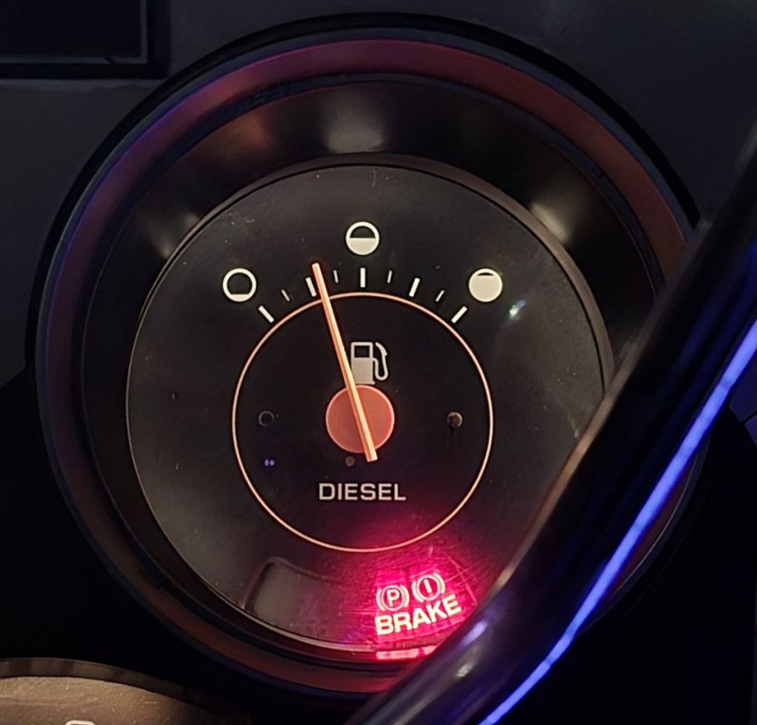

Not sure if its just me or not, but I swear my mileage isnt the best this time
Started at 284719
Current reading is 285023
Fuel level:
From Rapid to Minneapolis is 8 hours, my average speed was 85-90MPH, I have 4 hours left
Youll need to fuel up then tally gallons to miles.
