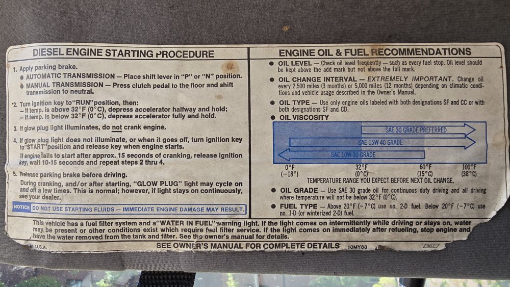

Fyi proper starting technique is push throttle pedal all the way to the floor once and then release before turning the key on.
