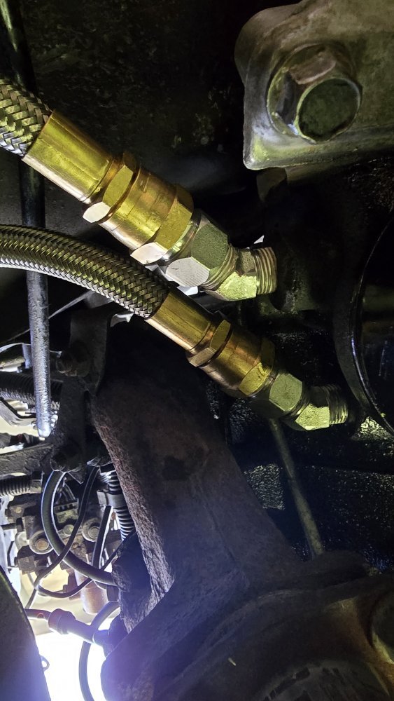

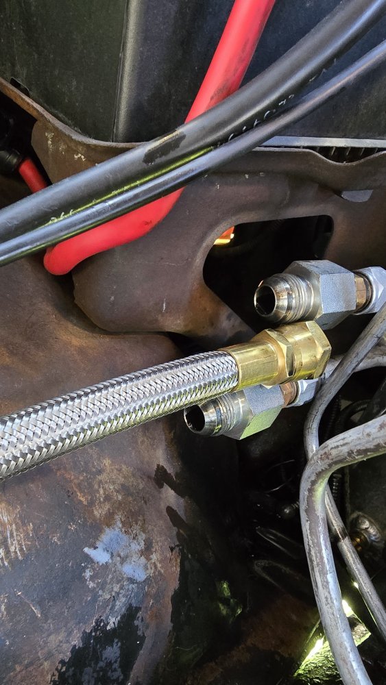

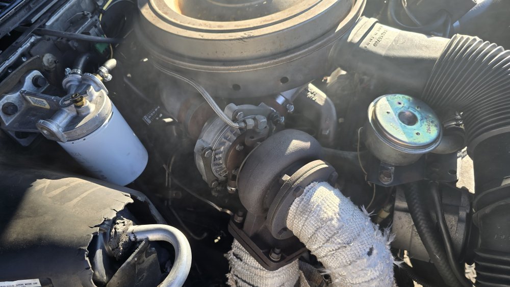

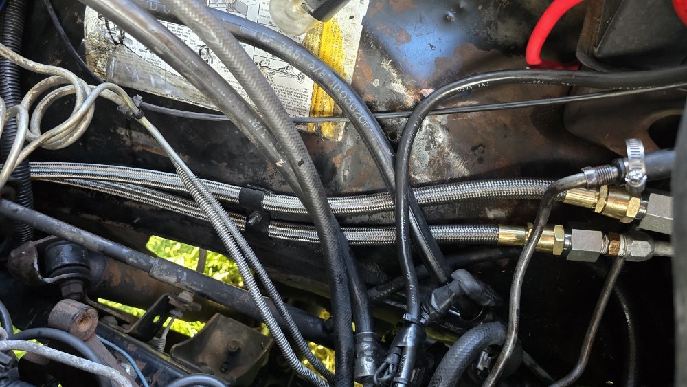

New lines and angled fittings have been added in! I actually able to use the factory line brackets to hold the new ones in, which was great, as it keeps them in place.

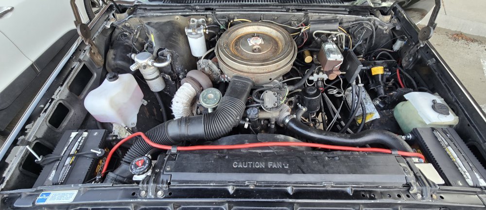

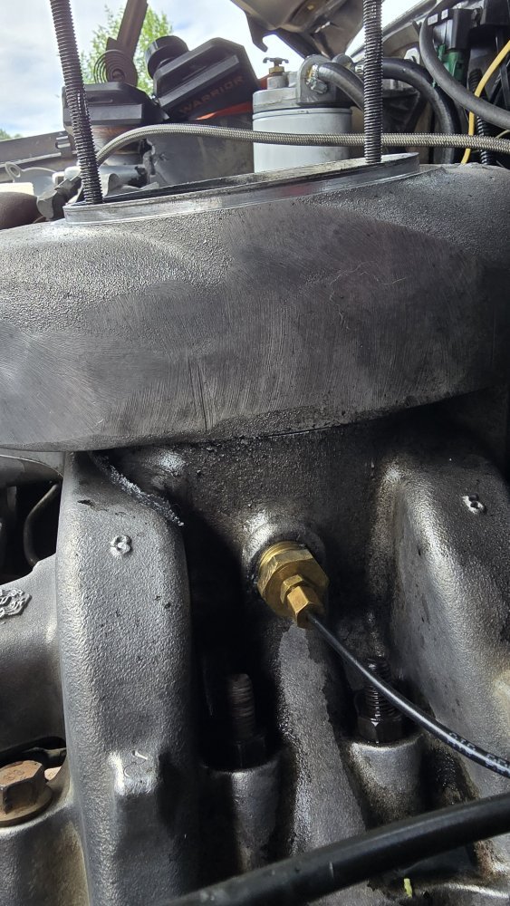

I was able to get a new air cleaner gasket from Oriellys so thankfully the gasket situation was fixed aswell, since replacing it, I haven't noticed any oil coming from the intake.
I also replaced the coolant overcome reservoir aswell, so now it has a more "factory" look to it, which I'm glad about as the one that came with the vehicle wasnt even from GM to begin with. Making the engine bay look alot cleaner.

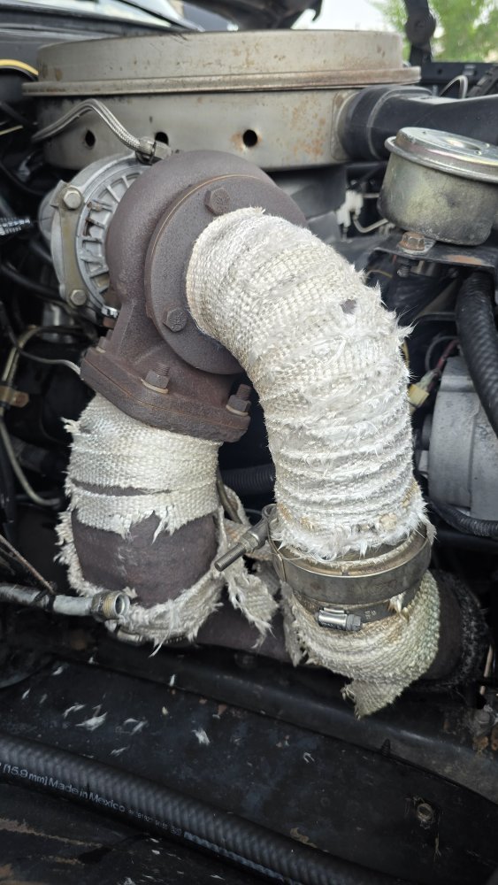

I realized when cleaning the engine bay that the turbo straps have begun to become undone, looks like ill have to find a replacement for them soon, any suggestions would be nice.

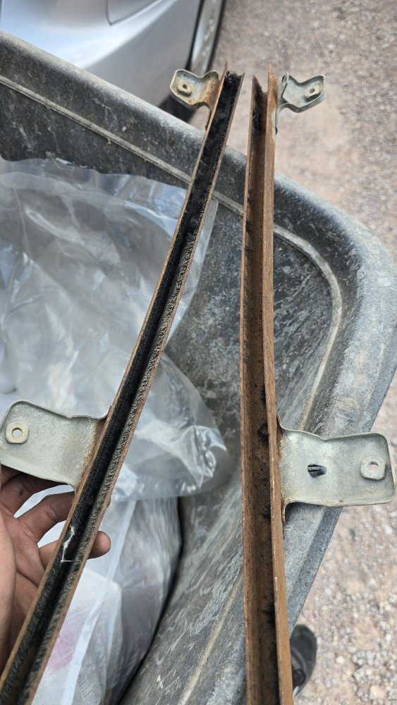

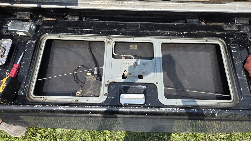

Not 6.2 related, but i actually finally got around to replacing the tailgate window seals, plus the rear window motor. The seals..... desperately needed to be done, the only downside (and this occured with the front windows aswell) is that it now struggles to open and close, other than that though, its nice to finally have my vehicle fully sealed
Haven't noticed any leaks or anything from that region that was done, will keep an eye on it, its doing well for now
