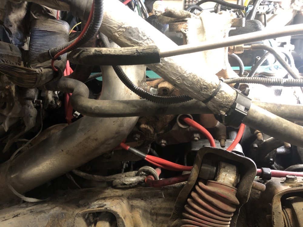

Guess there is no real answers to the best way of routing the PT GP harness to the right side cylinder head glow plugs.
The original harness was run under the intake manifold for the forward three, then down and to the right then plugging into each GP. The rear GP wire was run downwards behind the cylinder head then plugged into the no. 8 GP.
The instructions for routing the PT solutions harness is rather vague, at least in My head and so here is how I routed the harness. Dropped it behind the cylinder head, trying to avoid the exhaust manifold, then forwards between the down pipe and the manifold.
I know this is going to be mighty hot in the no. 6 and no. 8 areas of the harness so I might try running along the top of the cylinder head, just below the rocker cover, under the injector pipes and drop it through the exhaust manifold at the no.1 GP.
Here is a couple pics of how it now is routed.
Got the harness pulled and laid in like @ak diesel driver described. I think. 😹
At the GP level.
And on top of the RH side.
I laid the wires between the rocker cover and the bracket that the injector lines is attached to and also the heat shield.
