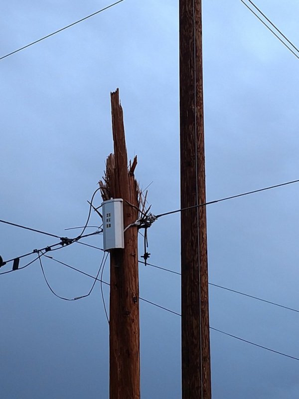

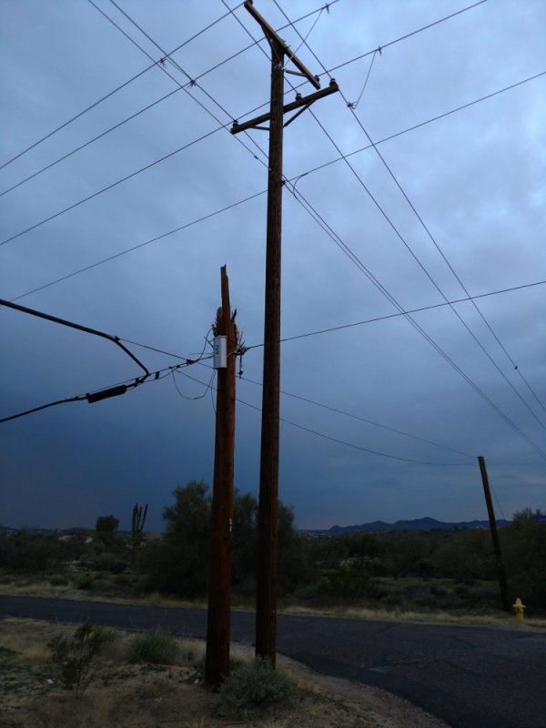

Getting some bids to do the project. Here is a snapped power pole from last year 2018 Monsoon season that put the lights out for 3.5 hrs at my place. Yeah new pole next to it...
Ah, so the cable company / telco did not want to do any work seeing as their line was good on what was left of the old pole. Nice . . .
There are a few poles around me that have a compromised base where they were 'fixed' by way of sistering some planks to them. Again, Nice . . .
