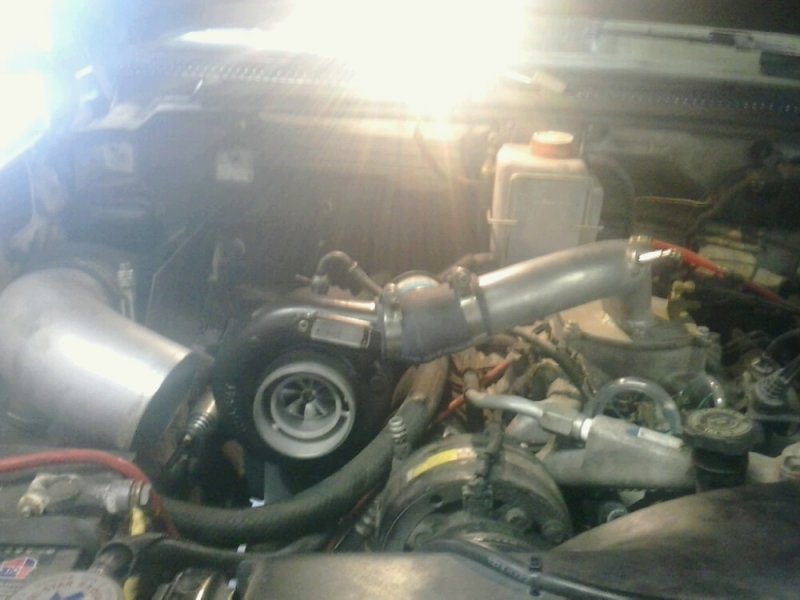

Well I went ahead today and built the hybrid. HX40 compressor wheel. Rest of it is 35. Although to avoid any machining I simply took the turbine wheel and shaft out of the 35 and put it in the 40 bearing housing and swapped my 12cm 35 housing to the 40 bearing housing as well. So if need be I can always swap back. But so far I love it. Gobs more torque down low.
