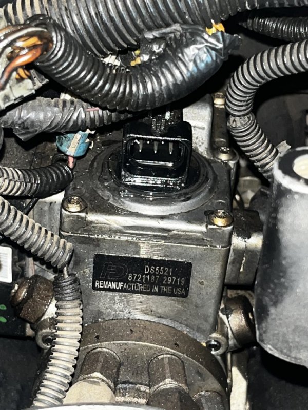

So here’s the current update. Pulled the intake / turbo tube and can see that the top of my injection pump is leaking. Must have failed seal. This is flooding the sensor… could be on to something.. sucks I’ll have to repair the pump. Hope I don’t have to pull it all the way out :X
You can start the engine with the intake manifold removed. Just be sure to protect the intake system from any leaking fuel.
Have some pieces of plywood or board ready to slap over the intake if leaking fuel gets to the intake portion.

Hahaha man thank you. I’m not super keen on terminology / parts but that may be it. The truck runs still tho…& when I pull that sensor from the IP it shuts off … I wonder if it leaking there would throw off the ground and effect the whole GPR / charging system? Needs to be repaired regardless… hekn frik
is it just leaking from where the snap ring is on the optic sensor? there is an o-ring beneath that. but you'll have to remove the top plate too in order to get at it. there are 6 torks head screws (one has a ground lead attached) carefully remove the snap ring first, then the 6 screws. slowly lift on the plate and once it's free from the IP then push in or down on the plastic sensor connector so that only the plate comes off. there will be a oddly shaped rubber seal under the plate, be careful with it because apparently they can't be had as a replacement part. the o-ring will be on at the base of the plastic connector of the OP (optic sensor).
make sure you keep ALL trash from falling into the IP as a single grain of sand getting in there can destroy the pump!
others will chime in to help give you better instructions, maybe even photos. one thing you can do is lookup youtube videos on doing the optic bump. ONLY use the videos as examples on how to remove and reinstall that plate and o-ring. DO NOT try the optic bump, as you will be in more hurt with problems!
one other thing.... the harness that connects to the OP... is there still a short looking extension with a little black square box in the plug? if so, that is a noise filter that has given many including myself random issues. remove it and toss it into file 13... the harness will connect directly into the OP.

That’s extremely helpful. Thanks for explaining it all. I was wondering if I’d be able to do it myself… to be honest I’ve tried to rebuild my turbo before & was unsuccessful. Thinking I may have better luck with this if I do my research and take time. I’ve contacted a local shop that rebuilds Them for parts & a quote on rebuild of that portion. I think I can do it myself tho…
I do not have a torque wrench/driver tho… is this 100% necessary to reinstall those torks??

I have noticed when I pull the sensor- the truck dies…which leaves me scratching my head as to why I’m having ground issues still.. when I play with that area I can get the glow plug to click rapidly…It’s hard to tell with my lack of professionalism, but it seems the two are closely related..
