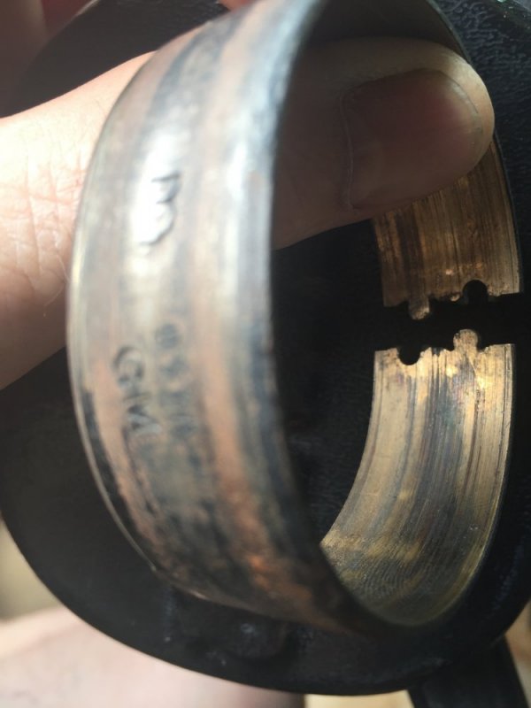

I still can't believe that after all the problems known to this engine that the cam bearing was the GM stamp and roll bearing in the new and improved engine. I wonder what bearings come in the p400.
Years ago I had a 454 drag motor and the cam bearing holes were a little on the big side . The builder knurled the back of one bearing and installed it . Never had any problems .
@NVW sorry, I never saw your question- block was undamaged, new cam bearings in, and problem solved. One thing I did was open the oil supply and return holes large in the block when I drilled them for lots-o-flow.
The bench test & road test oil pressure was back to normal specs when it went together.

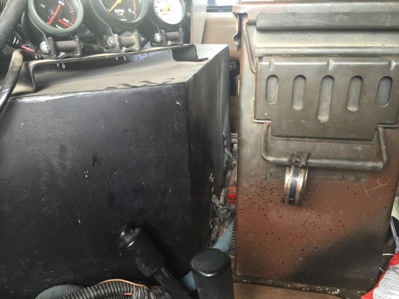

The optimizer engine uses the crappy GM split bearing design. Im not sure if anyone makes a true 1 piece anymore. Luckily it grabbed my cam instead of the block. Yes that really is an ammo box I am using to house my tcm, vssb, and as a glove box with 4" diameter drink holders on top. Im an idiot.

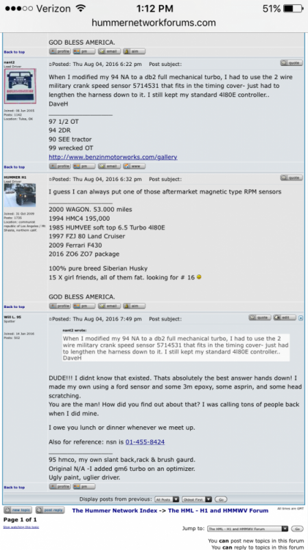

The reason I looked up this thread today was to add info i just learned of from a guy on a different forum.
2 wire crankshaft sensor available!
Part # 5714531
Or NSN # 01-455-8424
Credit due: DaveH aka nant2
