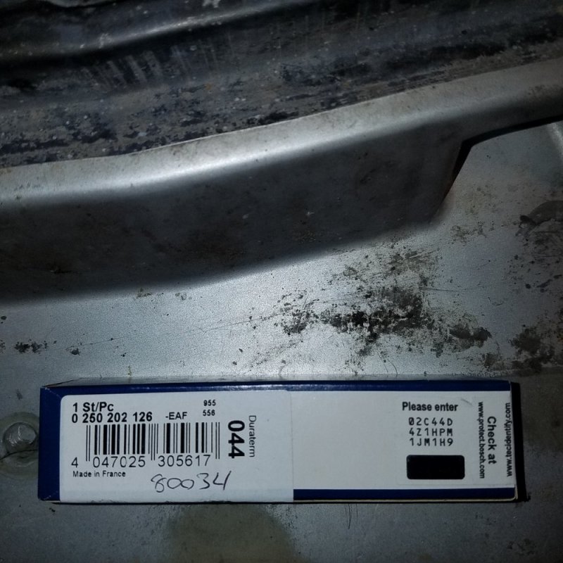

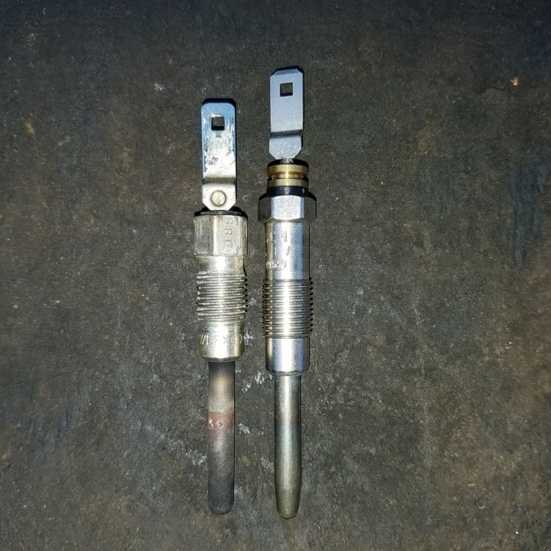

So, final solution was that 7 of 8 glows were shot. I ordered 8 more (Duraterms) and funny thing is, they are totally different from the first time I ordered them. I'm wondering if the company that I bought them from the first time didn't jerk me and send a different type? The new box actually says Duraterm on it and the plug is labeled Bosch.
Bosch on the right.

I dont thnk I have ever had a bosch plug that wasnt labeled bosch.
I had NAPA do some checking with their Bosch rep and came up with some numbers from that other plug. I'll try to dig em up and let you know what I found.
The plug on the Left is not a Duraterm. I thought it was at first glance an OEM AC Delco "9G" or similar clone. The rusty texture of the plug itself may be from too much timing aka glow plug erosion. Hopefully someone can comment if your picture is normal or in fact erosion. Keyword is "texture" not color that I refer to.
