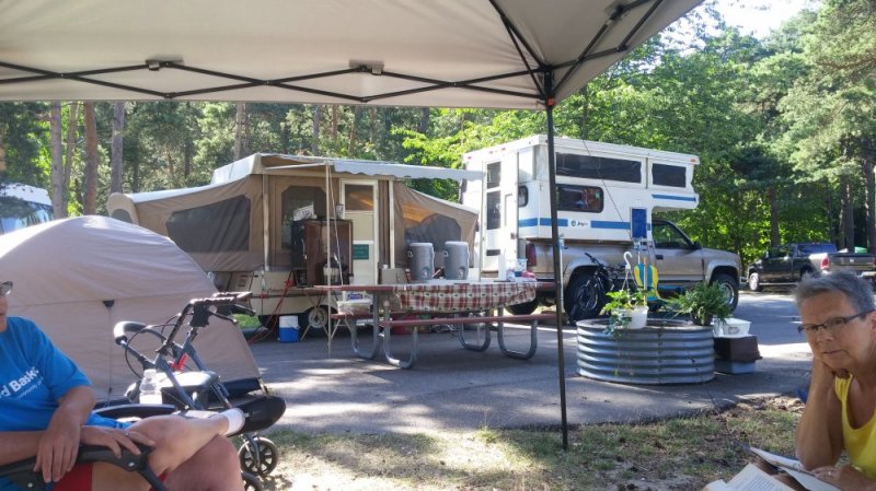

Got me a new camper. Woohoo.

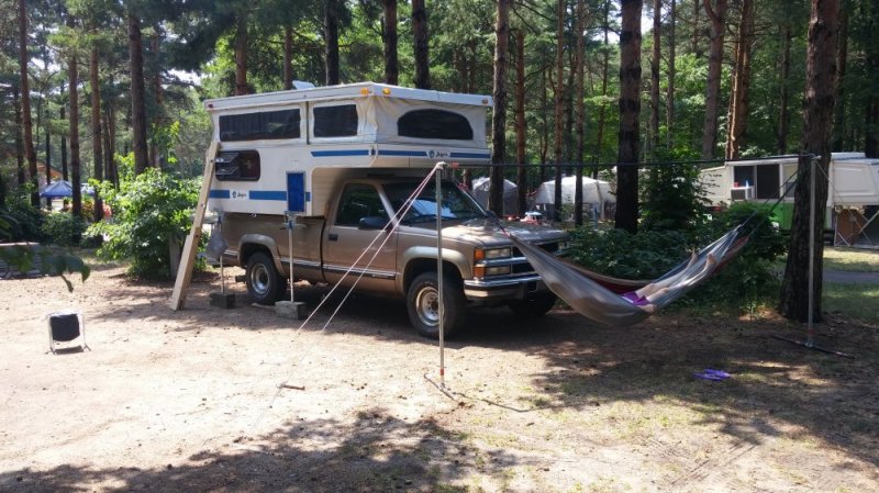

Leroy I've been meaning to ask you about your camper. If you have the split entry door could you take a couple pictures of it with the top down. The lady I bought mine from said with the top down water will come in through the top. There's no seal right there on mine.
