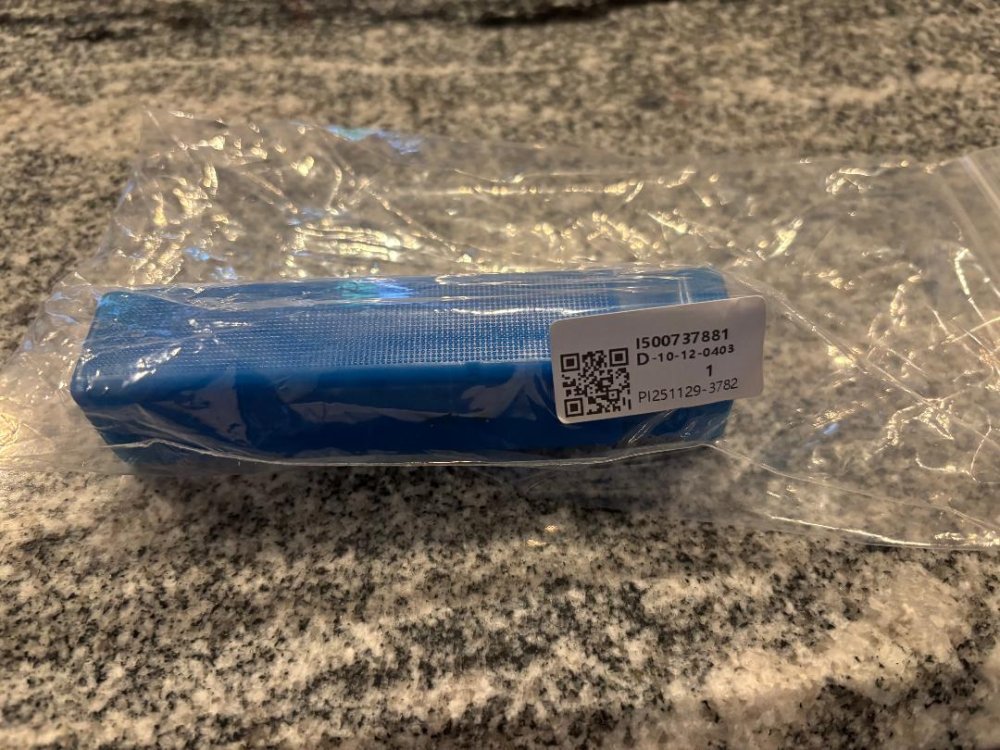

Received the ream ordered from Walmart at our Montana home and my wife sent me a pic asking if I wanted her to bring it down to SoCal. The packaging is the same as for the ream I bought from Speedway at 4x the price.

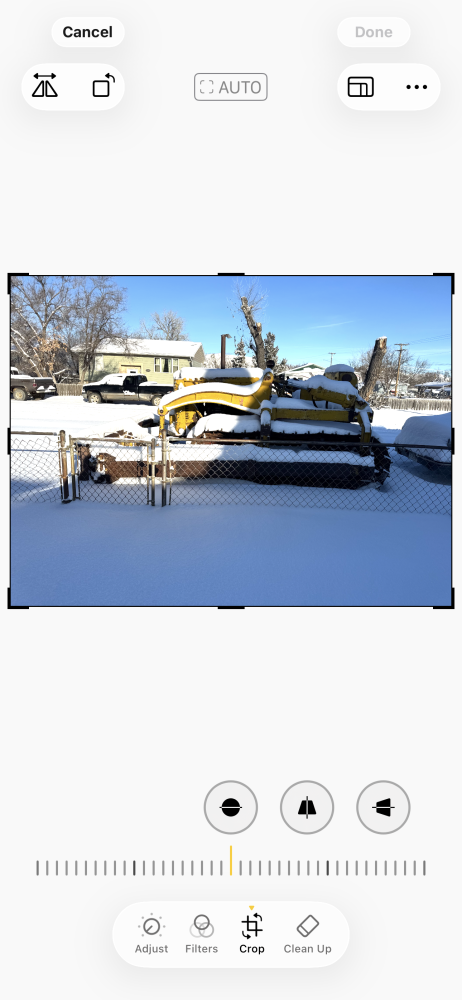

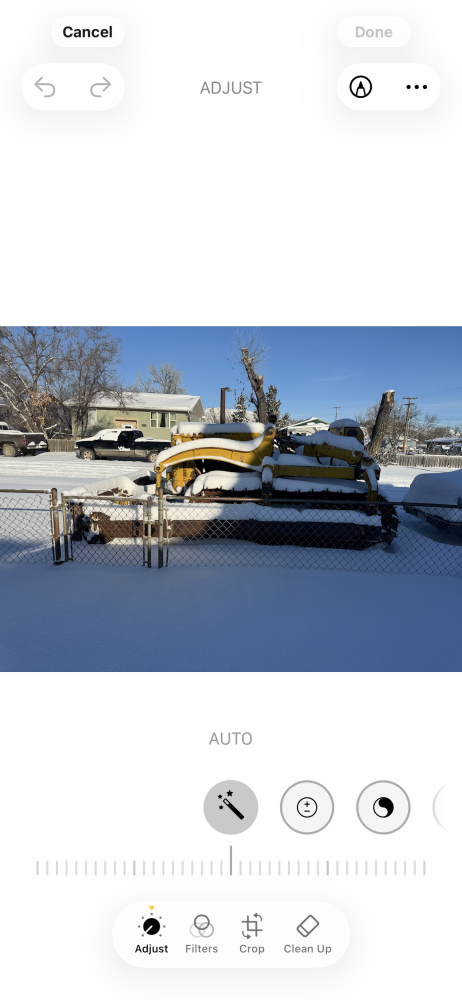

Heres some pics of my Rancho lift knuckles with the ball joints done. The knuckle is bolted upsidedown in preperation to ream the steering tierod ear but I rotated the pics 180 degrees so they look upright. Not sure if I'm going to be able to use the tie rod end in the photo or I may have to use heim joints sincs Rancho raised the tie rod ear 2 inches which makes a clearance issure with the differential on the drivers side.
If on iphone.
Go to photos, tap the photo You want to display.
At the bottom, tap the three lines with the o on them.
Choose the CROP option.
Then move the black border and corner markers to eliminate any unecessary portions of the image.
If the image needs to be rotated then at the top, left side, the square with the circular arrow, tap that, it will flip the image around, several times until its headed in the right direction.
After its shrunk or rotated to Your satisfaction then tap the done at the top right.
