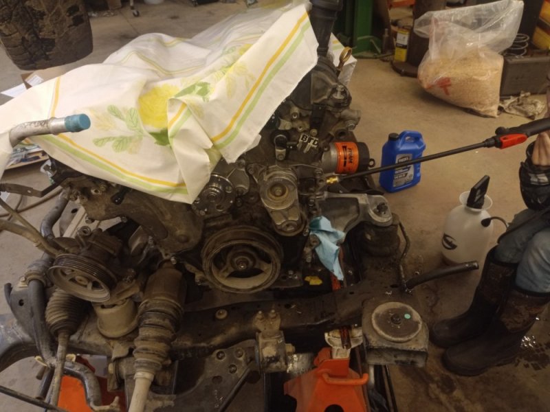

My homemade primer toolView attachment 70461
Adapted a rubber air nozzle tip to it and filling thru the OPS opening. Slow but it appears that I have oil to the heads
If a person could find one of those stainless steel water/air charged fire extinguishers, flush it out good, install a weed sprayer type of a hose/control valve onto it, adapt the tube to a ferrel to pipe fitting then adapt that to the oil pressure sensor port on the engine.
Cill it with oil and prime it up.
