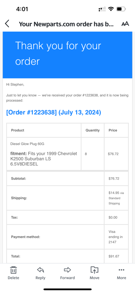

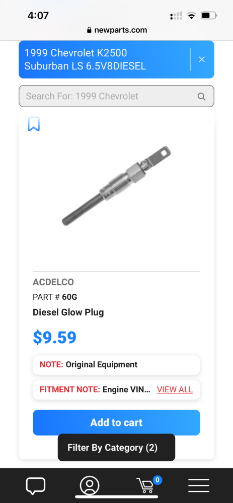

They were the only AC Delco seller I could find online af reasonable price. I’ll let you know when they arrive.I've not heard of "newparts dot com" before is this an authorized delco seller?
Have you tried using site?

Yes, a few years ago. It was a pain. I did figure out how to navigate the quirkiness.Have you tried using site?
I wonder where my local Delco store is.Yes, a few years ago. It was a pain. I did figure out how to navigate the quirkiness.
Once I found the part number, I walked into the local Delco store.
