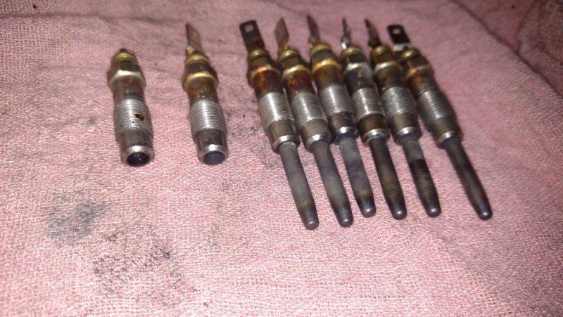

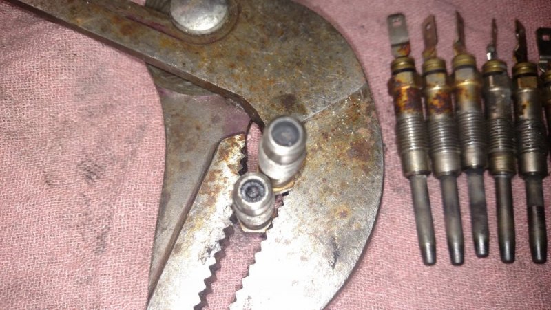

Here I a picture of the 2 plugs missing the electrodes.... Not burned off missing completely. The complete full length of the electrode fell thru the precup opening into the cylinder while driving, made a hell of a racket.
