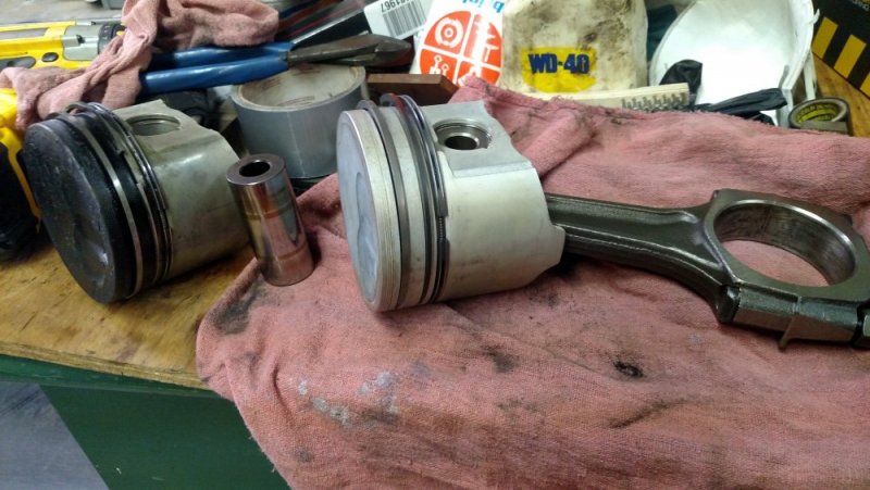

I know this is a very old thread, but thought I would post what happened with mine. It broke off while driving freeway stop and go traffic no load really. Cracked the Piston concentrically down both sides of the wrist pin to the oil control ring groove and strait across the one side of the Piston along the full length of the oil ring groove.

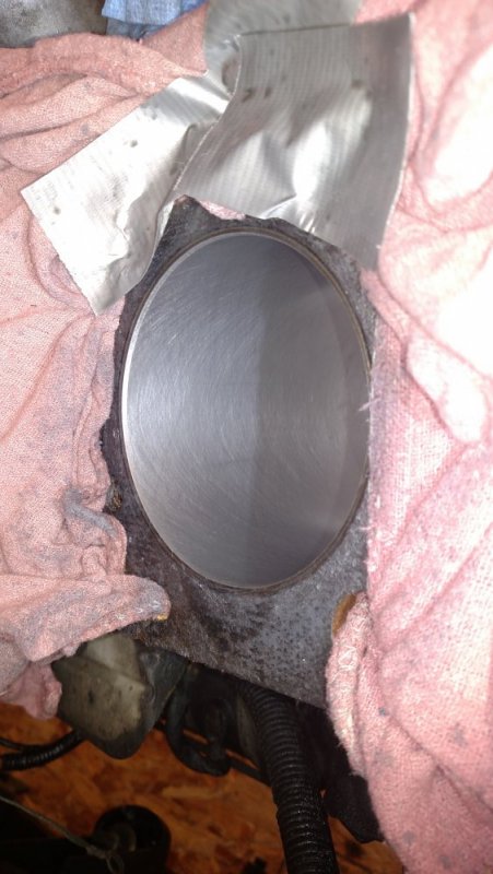

Luckily no damage to the cylinder wall. So far I have deglazed that cylinder reassembled a new piston and rings, replaced all the rod bearings while I was in there and had the head rebuilt. Bolted back up currently and hope to have it back up and running in the next few days. The engine was running with that cracked piston it just had a tick sounded like excessive valve lash.

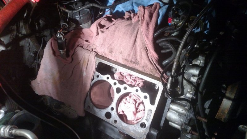

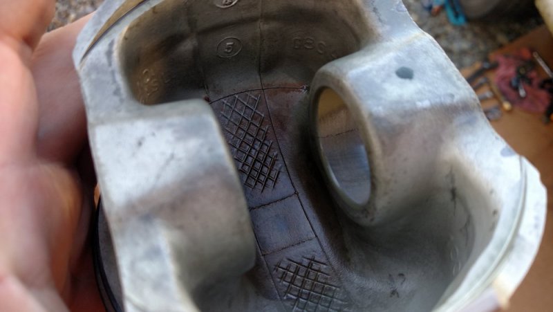

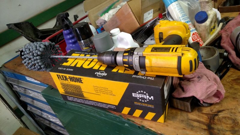

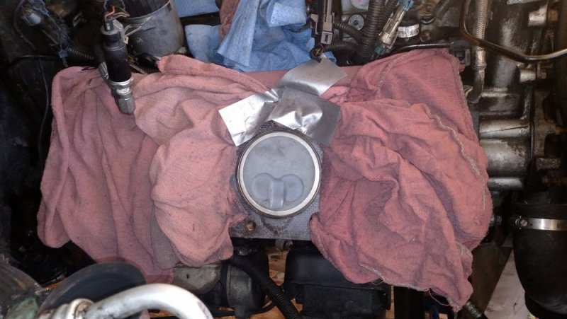

Here are some pictures of the repair in different stages.

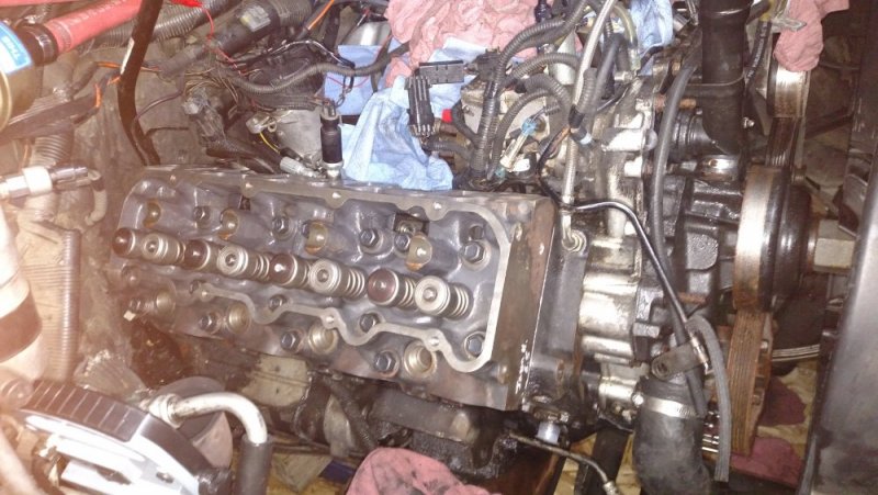

And the head bolted back up. I had that head rebuilt, the machine shop replaced all the intake valves said there wasn't any bent valves. They did a valve job and shimmed the springs set the valve hight and surfaced it.

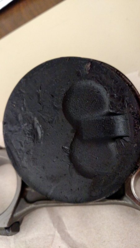

This one did the same thing with in the year the whole electrode fell into the cylinder. I purchased this truck and did a bunch of work to it one was put the Bosch glow plugs in which I have had in another truck for several years with no problems. I scoured the forums and haven't found any mention of others reporting similar issues, you have heard specifically of this same thing happening to others? The attached picture has 2 locations where the complete electrode was smashed or imbedded in the Piston crown.
