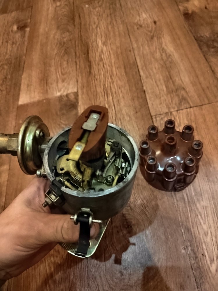

I have also saved the points ignition distributor for the 1959 Dodge W100 318 V8 engine, Just for the just in case. 😹

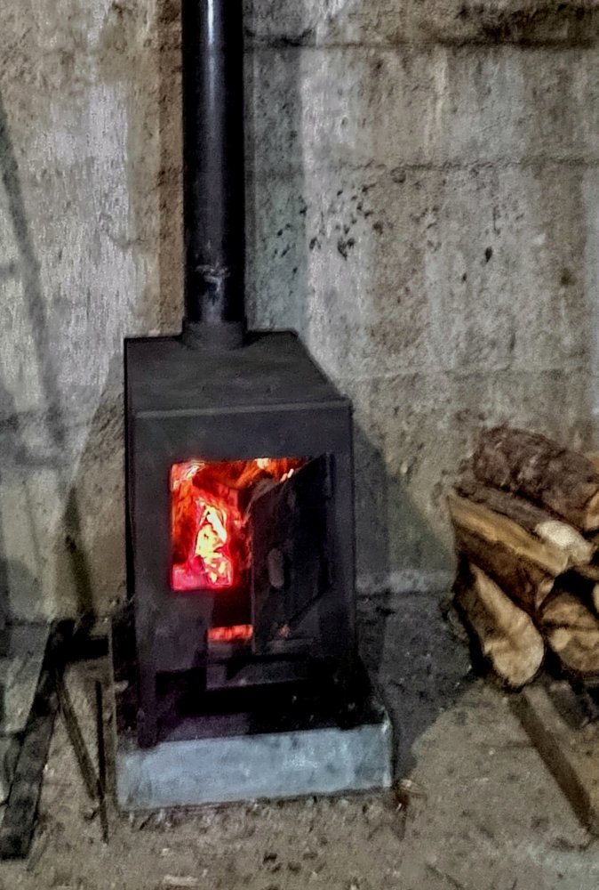

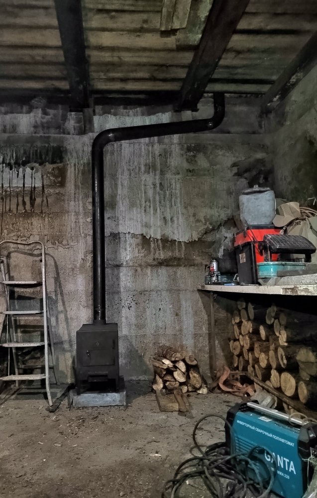

I welded a chimney from 108 mm (4 inch) pipe. The horizontal sections were pitched at 8°. To extend the chimney from the basement and through the wall of the upper garage, I used four 90° elbows. The two horizontal sections of pipe have a drop of approximately 5.5 inches per yard.
To help limit creosote growth, an occasional flash fire (once everything is already good and warm) to burn the creosote can work. Same idea as a controlled forestry burn to prevent a larger fire. But, if the creosote is thick, then you will get the equivalent of a destructive forest fire.
So, while a preventative fire can prove effective, there is an art to its execution. If those pipes are not able to handle a brief creosote burn, then it looks like you are stuck finding the best toilet brush.
Or, look around for a gassification burner. Near zero creosote. But it will need occasional cleaning of ash build-up.
In plumbing, this is what they do – 2x45°. A chimney slope is necessary to allow condensation to drain away; much less condensation forms if the outer (street) part of the chimney is insulated. When the chimney is heated, moisture leaves the chimney as steam, but when the chimney is cold, the steam condenses on the inner walls and flows back into the furnace. The amount of this moisture is negligible, but if the slope is not maintained, over time, the condensation, along with soot, will turn into a tar-like mass and clog the chimney.
Aspen firewood is typically used to burn off soot; it produces a lot of sparks that rise up the chimney and ignite the soot inside.
Aspen also produces high temperatures and does not contain resin.
