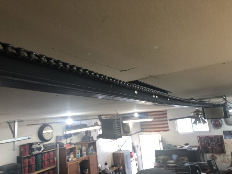

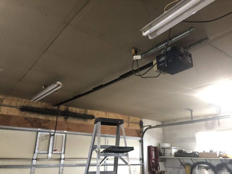

One thing I dont like about the opener setup is the stifener bar between the door and the motor. It hangs a couple inches from the ceiling and whenever the door is opened/closed, that bar bounces like crazy.
I’m wondering, if it would cause any harm to any of the components if I was to make up some brackets and mount them to that stifener bar and screw it to the ceiling to stop it from bouncing like that ?
Yes, no, hints or suggestions greatly appreciated. 🤷‍♂️😹😹😹

I can't see anything wrong with supporting that bar, if anything the chain will run more true.
It's the shock absorber for the system. Motors start faster than that door is going to move so something has to give a little.
I went with a jack screw garage door opener that also has a electric sliding bolt. Harder to use a coat hanger to get in via the emergency door release handle. Regardless I no longer have the "action show" on the ceiling from an opener. It's also out of the way for tall pickups.
