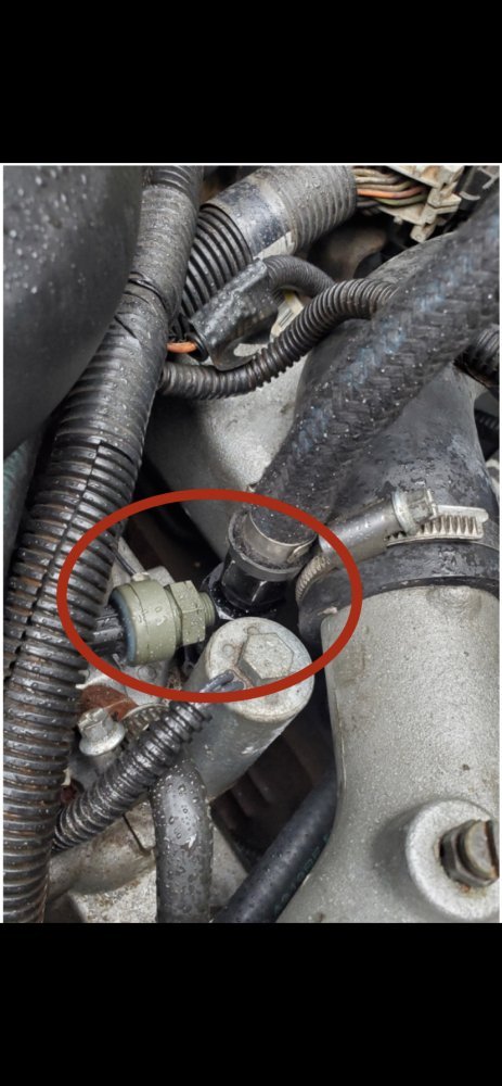

You unscrew the fitting that goes into the ip.
Install the Mod mafia fitting.
Screw your fitting into the mod mafia fitting.
Screw the sending unit into the mod mafia fitting.
Use teflon pipe dope on the npt threads. The flare fittings get nothing on them.
In the picture posted above, in the red circle you see the sending unit and it is screwed into the MM fitting. Above it you see the factory black fitting

Thats the fitting I have.
