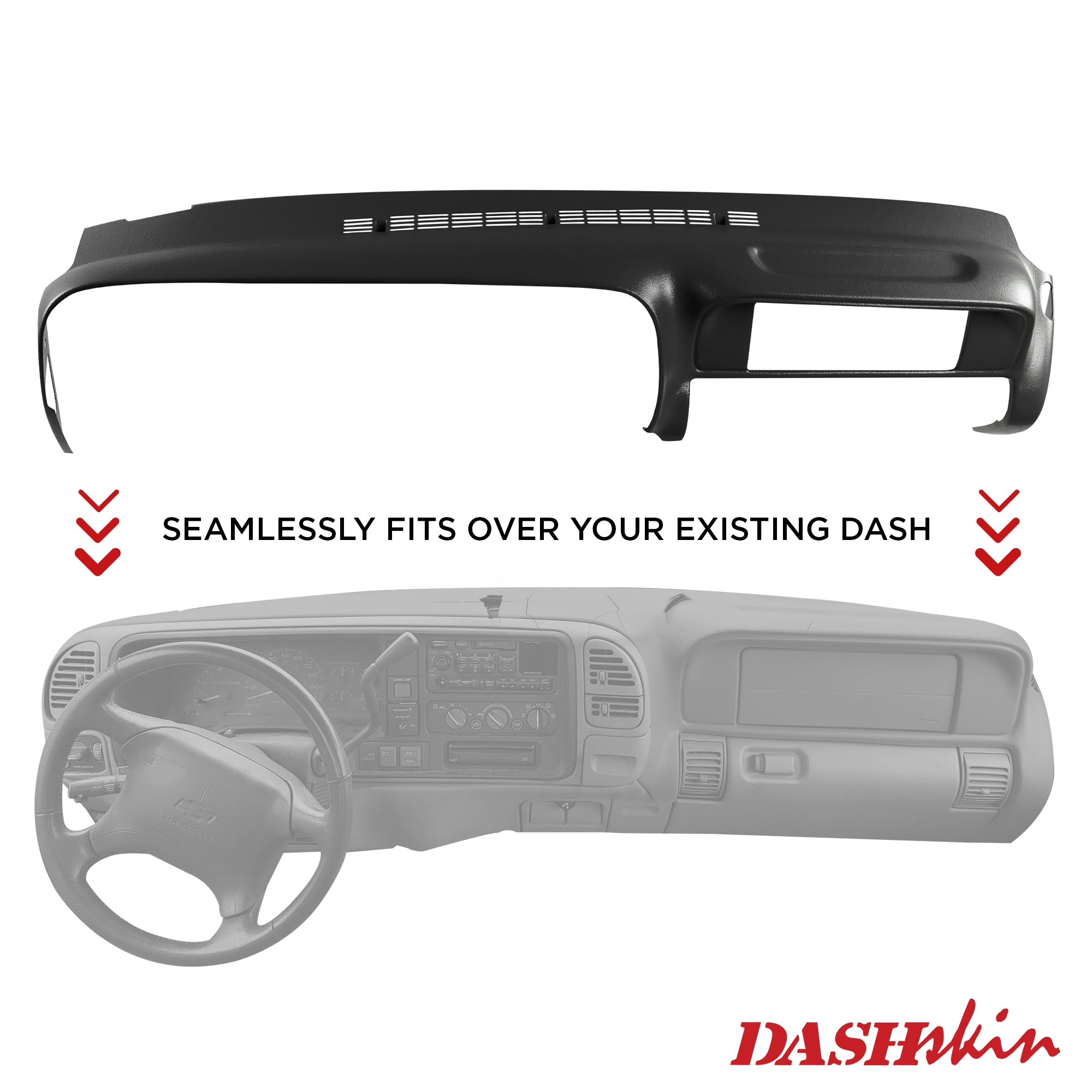

I never did a dash cover like this one but they are pretty simple.

Does anyone know if the '97+ dash cover fits the '95--'96 trucks?
IDK if there are any minor differences, but I think so long as it has the air bag raised portion it should be the same. 95 was a one off year where you could have a dash that had open cup holders in that area which would be completely different.

I have two cracks. Their site says:
“If you have cracks you will be covering, we advise cleaning your original dashboard well with industrial degreaser and bracing any cracks using extra 100% silicone RTV adhesive to prevent further cracking or rattling.”
What do they mean by bracing? Just squirt a bunch of silicon RTV adhesive? How does that prevent rattling when the shell that you are attaching it to is rattling? Should you repair the crack with a piece of metal back held in place by screws?
i would piece what you can together and use RTV or super glue on the cracks. then the RTV they are talking about is supposed to get sandwiched between the cover and the dash in various areas to hold it down but also on the cracked pieces to hold them into place so that they don't fall and rattle down inside the dash. bad part is later down the road when you decide to pull the cover off, it's gonna take a lot of the old dash out with it.
It is all one piece. Just the two cracks. I’ll take some pics.
That's not bad at all. a clean wipe down with some rubbing alcohol in the area along with some super glue to hold the cracks together, then cover it. if there is a crack forming, get a tiny drill bit and put a hole at the ends of the cracks to stop it from cracking further. just go light on applying pressure else you'll have a big mess!!
edit: you can use a soldering iron too along with trying to plastic weld the cracks before installing the cover.
That was my next question: would plastic welding help here?
Plastic Welding Machine Car Bumper Repair Kit
https://a.co/d/i90KTr4
Yeah- too thin for the repairs.
The glue on covers by for the top only are ok if you get the good ones, but it does nothing for the face. Then the problem comes in when you have to remove them for repairs to other components where removing is required.
Get a new dash, buy once cry once. Get a descent dash cover or do the clear windshield tint to stop the heat from cooking it- again the higher price stuff works way better for fighting heat & uv. The difference is are you selling it in a couple years or keeping it long term.
