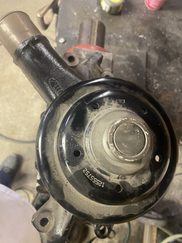

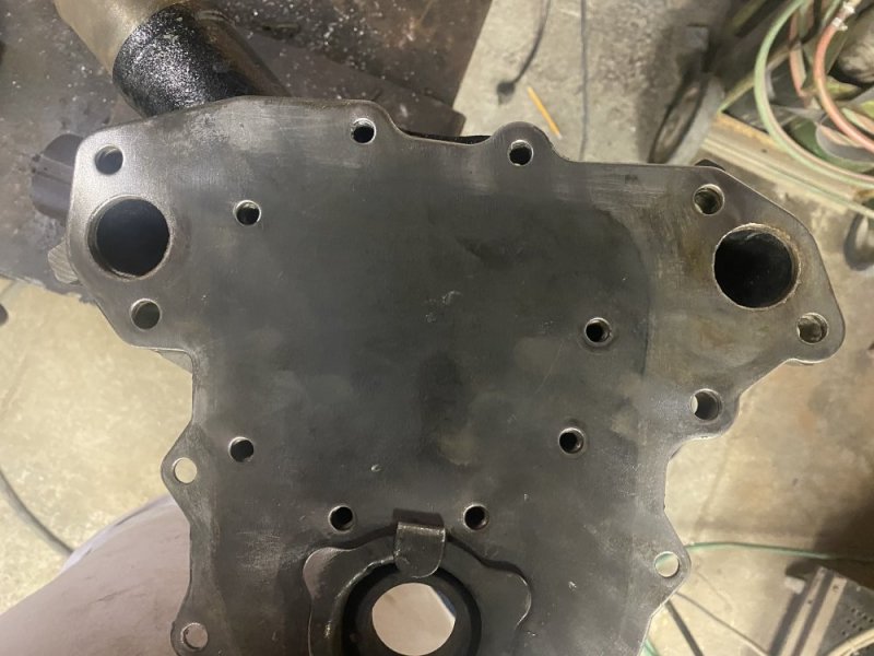

Ok. 3 texts, and 5 pm’s across the 2 forums... this is a balanced flow water pump with the backing plate on it. Later this weekend i can dig out a 4 bolt and show it. Yes I believe some aftermarket pieces of junk (edited for trying to quit swearing) are made with fitment as bad as flow kooler. But I have never seen an AC Delco fit so bad as the flow kooler did. The plate isn’t bolted, just set on it- yes slightly off, but the bolt holes are slightly off.
would I port match the backing plate to match any pump including AC Delco? NOPE. Not unless i put a 1993 plate against a modern plate and saw that GM (idk who stamps the plate if not them) made a change. Y? Because they made it work with this plate. And messing with the flow in the pump is exactly what I would avoid- they spent millions, until someone matches that amount or a good portion of it showing why- don’t mess with it because small changes made big effects in the flow.
