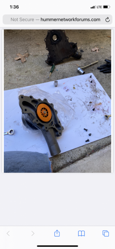

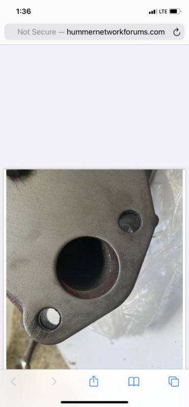

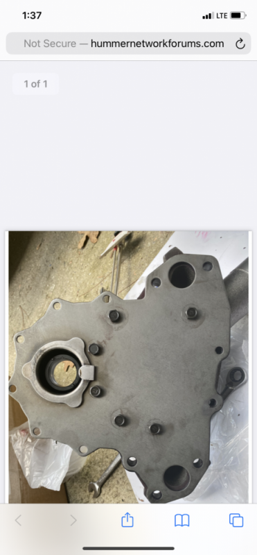

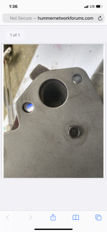

One of the hummer guys posted pics of his new flow kooler bolted up. Found out his engine was toasted, so didn’t get a lot of time on I guess.
But did post pics. Call them up you say? I quote “I called FlowKooler about it and the representative said that there wasn't anything that they could do about it since they are all cast the same.”
So i think 2 people said no known problems, 4 said they had problems and he had no conclusive decision on the one in the pic.

DCD855DB-E463-47C8-8B72-41B9EAA04F58.pngD3367C5C-7324-4A4D-9C7D-01C9377431ED.pngFBEC5175-5519-4D66-A1A9-F06458A00117.pngE7680797-6B08-4B4F-89A8-68165B4BE8E2.png
For what it's worth I have seen several Delco pumps that far off...
The biggest thing with the FK pumps is the aluminum pressed on the steel shaft without being pined, there is more of a chance of it spinning on the shaft...

Mine seems to be holding up so far. Didn't install myself so I'm not sure of the amount of casting shift, if any.
I installed mine last summer with the same variances. I emailed LeRoy diesel and he said he had not noticed that before.
So far, I have not had any issues. still runs 20-25 degrees cooler than with stock pump and fan.

Installed a FlowKooler pump on my friend's CUCV a couple of weeks ago. Had about the same shift as shown in those pictures. I suggested port matching it, but he was to eager to get it back together.
I have 2 more FlowKoolers on their way for my K1500 and the Optimizer for my CUCV. If they have that much shift, they probably will, I will try to port match them.
