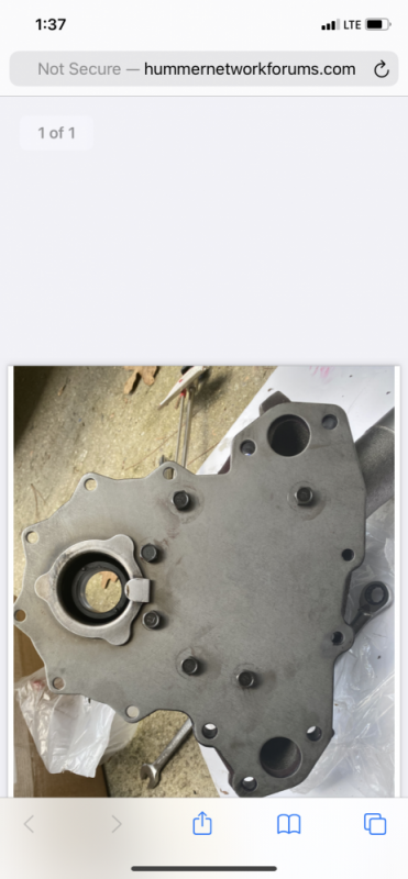

In @Will L. s thread, a pic of the pump and the backing plate shows that the ports on one side are not matched.
Just looking for ideas and opinions if it would be a good idea to use the die grinder and remove minimal material until the ports match between the plate and the pump.

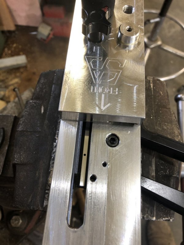

Step son is now in the garage scalping on his 80% lower receiver for his 1911 pistol kit. When he gets done I’ll have him help me to get the garage door opened, get the truck run in and get to work on the cooling system mods.
Thats the 1911 jig and frame with the scalping process just beginning.

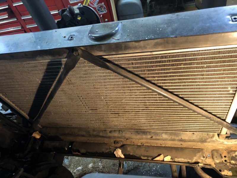

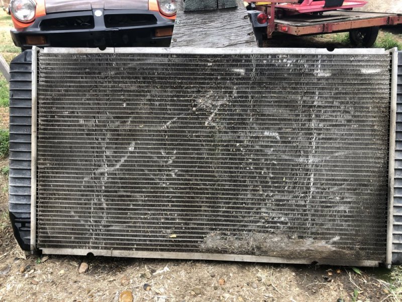

Oh yeah, the radiator is now out. The cooling stack is still quite clean. A little dingy bit not near as bad as I thought it would be.
When I first got the truck, I read about the importance of keeping the stack clean, i removed the upper shroud and the grill, got the components that could be moved loosened and then got after it with an old H2O extinguisher filled with a mix of degreaser and water. The oil cooler hoses had at one time leaked but had been replaced and none of the oil washed off. It was quite cold when I did that operation and I was working outside, I didnt know for sure how clean the AC condensor had come but it was plenty clean enough. I could mot imagine the amount of wheat chaff that was embedded in the radiator and the rest of the components but it seems I had got that blowed out quite well too.
