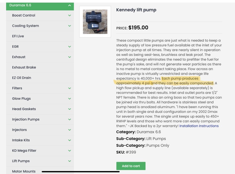

Not sure which lift pump you want from Kennedy but, his “same as the the one we sell for the duramax” is listed at 4psi. I looked it up on his Duramax offerings since his 6.5 advert is low on facts. Here’s a screen shot as I’m sure I can’t post the link and have it stick.
Wow, $195 for 4 PSI and you can double them to get 6-7psi for only $395 (wiring extra). Yes, I know, Duramax systems are much different etc.
Don’t know what the “universal LP” is rated at but, doubt it’s much more than the AC Delco. Might as well hit up Leroy or another vendor of choice for the (my pref.) AirDog with the water and 2 micron filter. Save some plumbing for the Pre-Filter and you could ditch the FFM at the same time.
