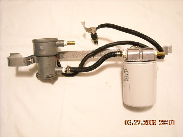

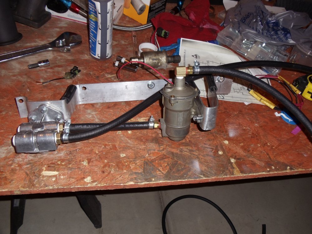

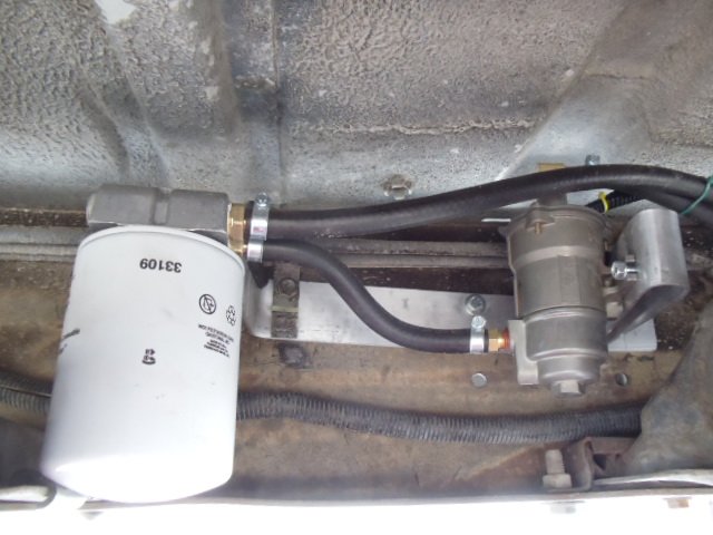

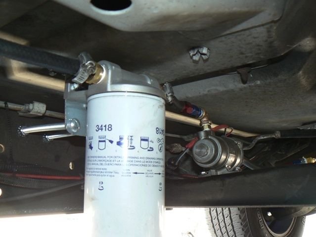

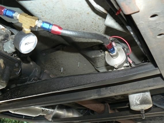

Can someone show me how they installed a filter before the Lp?
Ok. That helps. What kinda lp is that
Nope, Mine was the FRB-5 (found the receipt)Walbro FRC-10
(FRB-5 is for the DB2 non electronic IP.)
Add up the cost of all the ones bought and compare it along with ip lifespan loss and mechanical repair time to determine when one of the big boy LP becomes worth it.@Paveltolz does it keep up with the fuel demand under load? I'm curious since every LP I have tried always gave me good pressure at idle but as soon as I went under load like accelerating up a freeway on ramp pressure would drop to almost nothing till I was up to speed!.
Sorry Amigo, If I wasn't gifted the AirDog, I'd still be running the Walbro but, passed it on to someone else back in 2013 and can only say I don't remember it dropping off more than a few pounds at WOT. If it had, I think I would have remembered...being pretty unhappy about it. Plus, I wouldn't have passed on a POS to anyone.@Paveltolz does it keep up with the fuel demand under load? I'm curious since every LP I have tried always gave me good pressure at idle but as soon as I went under load like accelerating up a freeway on ramp pressure would drop to almost nothing till I was up to speed!.
As WW pointed out, the FRC-10 is/was supposed to be for a DS-4 but, the point is moot as Walbro doesn’t list them on their site anymore.
Are there any good - pumps that will last a long time and make proper pressure - that are flow through on fail?I called Walbro and asked why I couldn't get these anymore. They retooled their factory during the slowdown from the lockdowns and they simply haven't made another production run of these.
One other difference of note is the higher pressure pump would pump on a timer regardless if it needed to move the plunger or not. So it was a steady ticking from the FRC. The lifetime in hours on their site is less than the FRB and this is likely why.
The FRB will pump when needed. So you open the water drain and you hear the pump click faster.
These plunger pumps are "Flow on fail" so fuel can still flow if they quit. Some the high end pumps mentioned above are "Instant engine shutdown" and call the hook to drag it home. When the brushes failed in a lift pump I was using, well, just another coast to a stop on the side of the road through 6 lanes of traffic...
Of the large pile of dead lift pumps in my graveyard the FRB-5 outlasted them all and even the pickup. Marginal for pressure just like most of the others though.
 Looking to source a lift pump. Was going to go with direct fit one from Quadstar but it isn’t listed on the site anymore. Did anyone find out the psi on the LP from Kennedy?     I was planning on installing a filter before the LP, delete the sock and use the stock FFM. Any suggestions would be greatly appreciated. Oh I guess you can’t get transmission lines for these trucks anymore either. Have trouble sourcing these to. Thanks.
