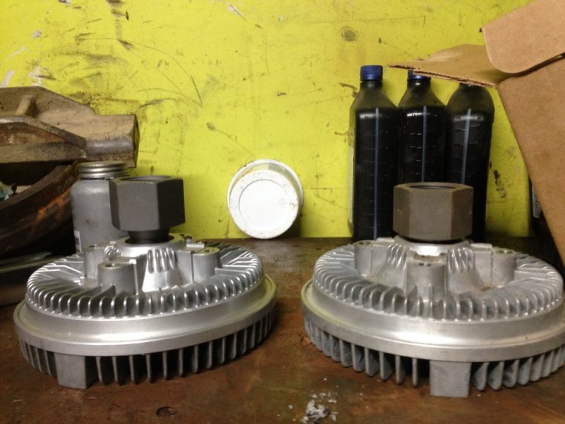

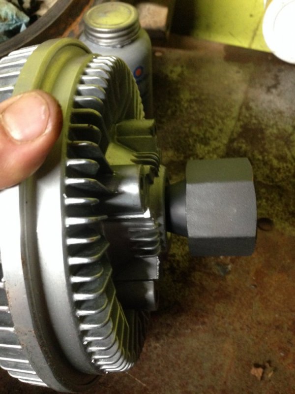

DieselAmateur, do you have a picture of the 2886 fan clutch? I just did a bunch of work to my Suburban including installing a new 2886 fan clutch I bought from RockAuto that I swear is either the wrong fan clutch boxed in a 2886 box or a dud since it has not engaged or have heard it engaged after driving it about 200 miles. It has a shiny metal shaft and nut portion that looks different than the cast grey color nut I see in pictures of other said 2886 clutches. Thanks.
@dieselfuelonly I'll find it in the shop and post it here. From what I recall there's a slight gap between the nut and back of clutch on the 2886
