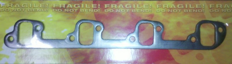

Between the manifold and the engine? Do you mean you just never had them there or didn't come with any?
So it shouldn't hurt anything?..I know they have them cause AutoZone sold me a set of new ones..lol

Over 20 years they warp, get oil soaked, the bolts rust and loosen up, etc.... if you use gaskets you will be doing it again soon, best to remove it, find a nice big belt sander wood workers use and hit it a lick, use the red high temp or better the high temp copper sealant made for this, thin coat, install and forget... and don't use other kinds of bolts, these exhaust bolts have a bit different pitch so they don't loosen up.... I have a link for them if needed, they aren't cheap but are stock oem replacement's...
Let us know if you find gaskets, my bet is their aren't any... and yea I know you can buy exhaust gaskets, a lot of stuff can be purchased that isn't needed and or recommended , like valve cover gaskets..

IIRC the threads are round instead of pointy when looking at the side view. Not necessarily an odd pitch. Also Leroy used to have some Remflex exhaust gaskets. There was someone on one of the sites that had them custom make them and I guess the manufacturer did a small run of them. Supposed to be the ticket for slightly warped manifolds.

If both are really straight, You can install the manifold against the head without a gasket. Any fine seeping will seal up with soot and be good in 1 day. Otherwise use a gasket. The metal gaskets last the longest but dont make up for scratches or warping as well as the paper style. You can even stack a couple gaskets against each other if needed. This is done when using the turbo manifolds on the long injector 6.2 heads to clear the injectors. Another option for sealing is using copperkote on the Gasket.
