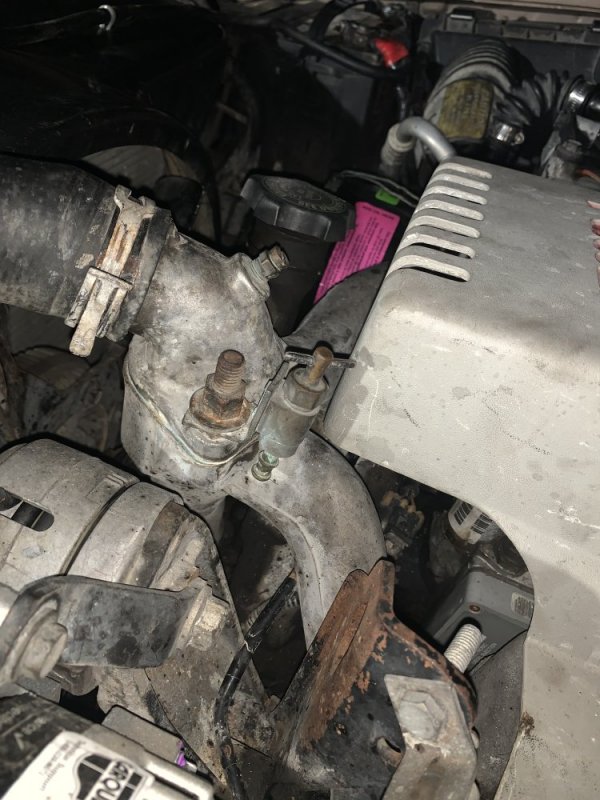

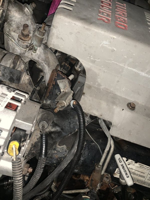

on a side note, today I ended up having to replace my PS pump due to not being able to steer too well at idle. made it really annoying while trying to park in a lot, but got that all fixed up now. ended up power washing all the engine compartment making it nice and clean :) while I was in there I noticed two small petcock valves, one mounted on the thermostat housing and the other mounted on the lifting eye just behind the alternator. they both had hose barbs on them but nothing was connected to them as if whatever it was got removed. they look factory but what were they for or what did they control? I was thinking it may have had some small coolant lines going to something but I couldn't find anything else on the engine where they might have connected to!
One is the drain for the fuel filter
I just discovered that while reading in the forum stickies and looking at pictures. Is there somewhere I can find the origional hose routing for the fuel drain and how the other valve was connected? I was just reading some of the stickies but havn't yet found how the lines were supposed to be! this might be an ideal opertunity to do the clear fuel line thing to check for air.
There is only one drain. Don't know what the other one is for. There should be a 1/4 hose going from the filter to the petcock under the intake manifold and then a short hose from it pointed down.
The one on the thermostat housing is for bleeding air from the cooling system .
I’ll have to have a look at the filter manager to see if one of the lines are plugged off. Here is a couple of photos of the valves. The one behind the alternator I’ve used to secure a harness with a zip tie

I suggest that you take of the cover that say "Turbo" and you will be presented with a whole new world of views.
The hose is routed under the intake.
If your is completely missing and the connection at the FFM is opened, then that is the source of air in the fuel system.

I actually just installed the cover LOL it's been laying in the tool box since I bought the truck :) thought it would look better after I power washed the engine last weekend! I do however plan to pull the intake sometime soon to replace all the rubber fuel hoses and hopefully get the drain line re-plumbed just for maintenance. the valve covers are seeping as well so that will get fixed at the same time as well as repairing the threads in the intake where the center rear plenum bolt is. I have thought about the "Feed the Beast" mod on the fuel filter but not sure about it yet.
